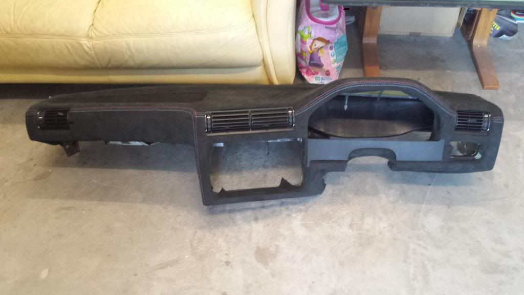

            Cover your dash in Alcantara with M-stripe stitching.
            [IMG][/IMG]

                  Normally I don't like the idea of cloth re-covered dashes, but that is pretty ballin. How much did that custom job cost you, if you don't mind telling?
                  I spoke with a local automobile upholstery specialty shop on Friday and it sounds like there is almost nothing that can be done to restore an OEM dash to like-new condition once it starts cracking. Any sort of vinyl covering is going to crack again in the same places, sometimes in a week, sometimes in a few years. An alcantara-type cloth covering sounds like the only complete/permanent option that won't crack again. And it sounds expensive since it is a lot of skilled labor to do it.

                    • Brisbane E30
                      • Jan 2013
                      • 99
                      The final price came to about $2,000.00AUD. That includes the dash, centre console, instrument binnacle, front and rear door cards.
                      The most expensive part of the entire process is the cost of the cloth itself. Here in Australia it is $250.00 per metre.
                      Hope this helps.

                        that is gorgeous for sure...and 2k aud for all that is fair IMO>
                        but did he put the steering wheel on the wrong side.,strange
