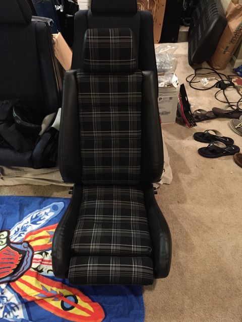

        I picked up my interior kit from John last weekend and have started installing. It's extremely tedious work to get it to sit correctly, but you begin to get a technique once you're on a roll. This is my first front seat mocked up for a pic (no brackets installed). I used all new OEM foam so the bolsters look a little wrinkled because the new foam is not shrunken like the old. At least that's my guess. I think after being in the car for a bit with some use and heat cycles it will smooth out great. I'll make a new thread once it's all complete and installed.
        I will echo the comments from the OP on John being a solid dude and standing behind his work. I have been very pleased with my order and can't wait to get it all wrapped up and in the car!

          That looks awesome. My only regret would be not going with a red plaid. But it is done. If you haven't finished, he suggested securing the bolsters from the inside first and pulling them tight from the outside, then once both bolsters are on do the centers. The layer of foam he added on the underside of the fabric makes the sport seat much more comfortable

            That's exactly what I have been doing. I started with hog ringing the bolsters on the inside using the wire inserts and then pulled them tight as I could around the outside before punching the spike points through the vinyl. I found that trimming some of the excess material on either side of the seam on the inside of the bolster seemed to help a bit. I think with a little time they will work themselves into a wrinkle-free fit. After the bolsters were in place I laid the centers in and worked them to the best position. They take a little finagling, but the end result is worth it. I think I spent a few hours on the first seat bottom honing my technique and figuring out the best way to secure everything on the underside with the hog rings. The time spent will be well worth it when done though. I actually considered the red plaid myself but ultimately went with the black since it's a touch more subtle.

              The summer's heat has helped with working out some of my wrinkles, mainly on the corners of the rear seat. And I had to trim the front corners of my front seat bottom centers to get them to fit snug. I think the back seat took me 3 hours, and the fronts took almost 4 hours each. I was so glad when they were finally done! My hands hurt for a week after
