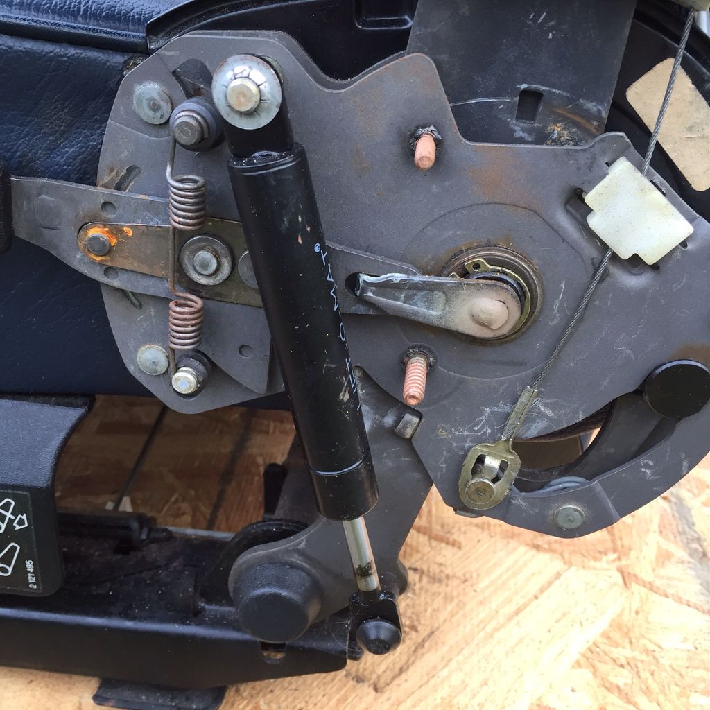

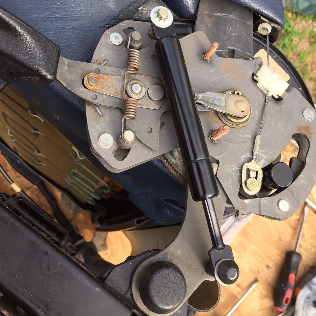

                  I did an install on a comfort seat and it works great.
                  Old
                  New
                  Side by side
                  Alice the Time Capsule
                  • jeffnhiscars
                    • Jun 2011
                    • 6010
                    #39
                    Before I share some notes let me just say...these are under high pressure and ARE DANGEROUS. You therefore buy, install and use them at your own risk. I use a pistol grip clamp to install them and remove the pads so the shocks sit in a groove. DO NOT use anything with a flat surface at they can easily slide off and DO DAMAGE.
                    In other words please be careful :)
                    Ok. Observations so far.

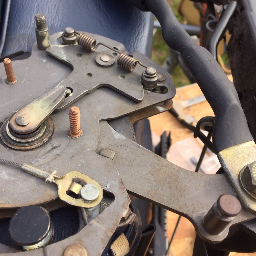

                    My comfort seat only had one shock for the back which I'm thinking is due to the comfort seat weighing less. My drivers right side hinge was a Hybrid meaning the top spindle was standard and took the push nut. The lower end required a fork.rather than cut the shock I ground the spindle in the hinge. DO NOT DO THIS. The spindle designed for the fork is too short to take the push nut so just cut the shock half way through the hole (of course you then own it forever)
                    My hybrid hinge
                    You can replace the bottom shocks by just removing the plastic hinge covers. While I suspect you can do the back adjuster as well if you make some kind of doohickey, it's easy enough to remove the seat back
                    The shocks are designed to lift the seat, not you so while it's easiest to adjust when you are sitting on it, when you push the release lever to raise/lower the seat bottom, grab the steering wheel and LIFT YOUR ASS. This protects your cogs as well as your shocks.
                    Install them piston down. My understanding is that while they are gas filled there may be a bit of lube in there to protect the seals.....so piston down.
                    Make sure your hinges are not full of crap and unless you live in a dust bowl I'd suggest some light lube. The freer they move the longer your shocks will last. Don't forget the pivot points for easing and lowering the seat. I've seen them pretty corroded.
                    That's it for now. Have to do a sport seat before I roll these out.

                      Did the sport seat and I'm satisfied that you will be as well. Make note that the black aluminum caps will not fit on these push nuts so if you want to reuse them try to save the push nut they come with, which WILL fit over the push nuts I'm supplying.
