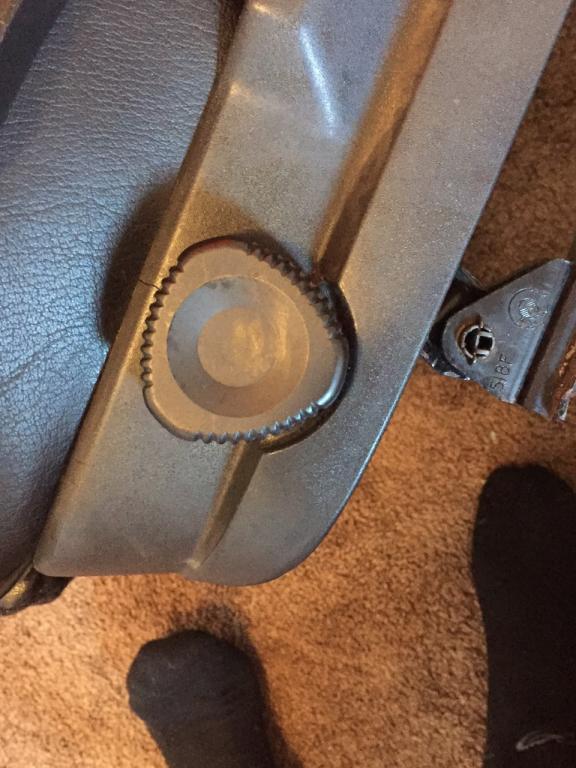

    Hello. just bought a set of Anthrazit Seats. These are BMW code 0269 cloth. I am starting the process of reupholstering/repairing the drivers seat and I need to remove the plastic cover but Im having trouble with trying to remove the adjuster knob for the leg support. I already removed the pins to the plastic cover as well. What is the proper technique to removing it? Thanks

    There was a similar thread awhile ago that I posted on. This should help you out:
    Originally posted by td325ic
    The first time I took apart seats I too had a hell of a time with that knob. But it's a piece of cake now that I know how.
    Just take two tools, like a hammer or adjustable plier, and at the same time lever it up on both sides. Even the most stuck on ones will pop off with little trouble.

      Thanks!
      http://www.r3vlimited.com/board/showthread.php?t=188052
      That worked great, thank you!

        When prying it off try not to damage the plastic cover

          ,,,, exactly ,,,
          yes a long flat head screwdriver can work it with cloth between plastic & screwdriver
