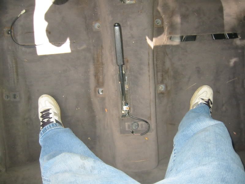

              VHT black carpet dye over original grey carpet

                ^^^ That still looks very gray.

                  Still looks pretty damn good if you ask me. Maybe before and after pictures would show the difference more.

                    It does look good, but if I were going to be dyeing my carpet black, I'd be pretty disappointed if that's as dark as it got. I'd take it to an upholstery shop.

                        yeah it looks pretty light in the pictures but its very black in person, and its not as dark under the seats....whos gonna see that.
                        Thats 6 cans VHT and it has held up fine for about 4 months now, the total was like $25. I had the carpet pulled anyway to dry out so I just dyed it, i am very pleased.

                          heres a before.
