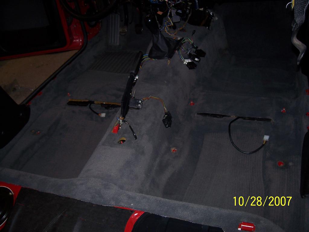

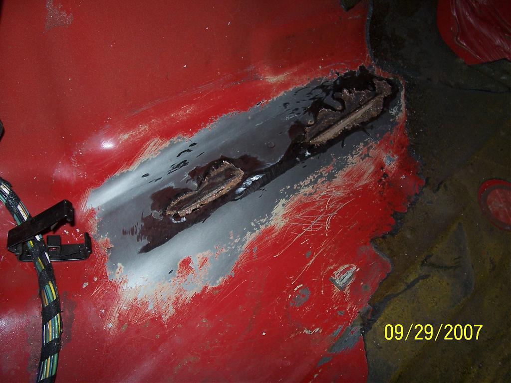

    Meant to post this a while ago but never got around to it. Things started with a leaky heater core and cooland inside the car. Since the carpet was crappy fitting aftermarket stuff I thought I would change that out while I was in there. Then I found a nice rust hole on the pass side above the exhaust shield:

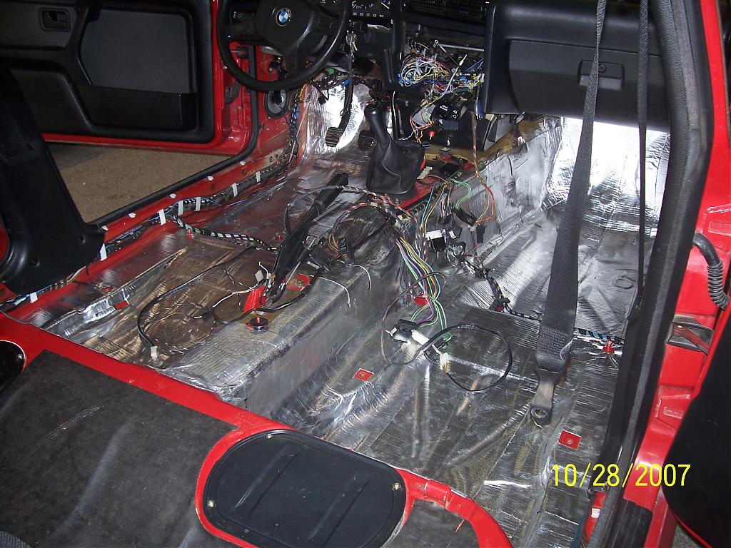

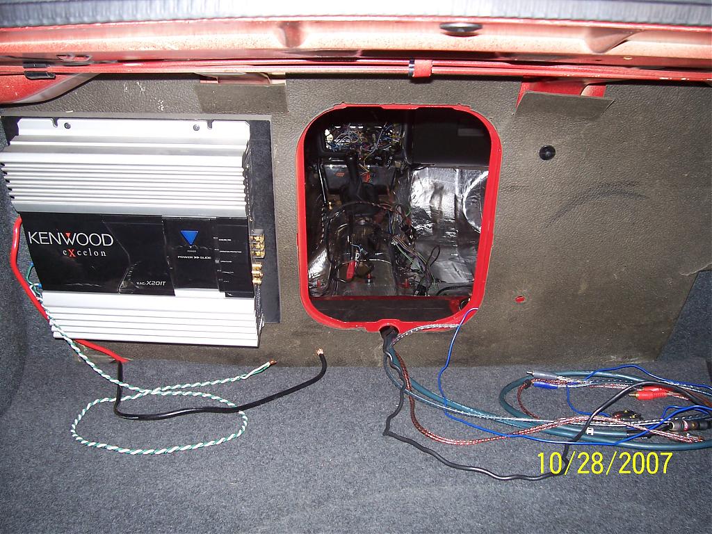

    So after some grinder time and epoxy that was fixed. Then I decided to lay down some peel and seal just to take the edge off the highway noise. as well as add heated seat wiring and ran extra RCA cables for future ease of installment of seats and amp.
    Found some fairly clean 4-door iX specific carpet(not easy to find) from Reggies motor works and just power washed it with purple power and as you can see it came out pretty nice.

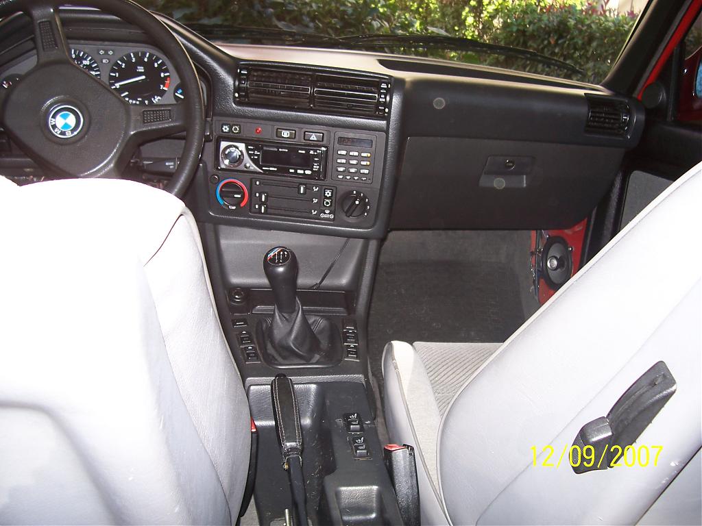

    I then added factory tweeter domes and a 7413 HU and it's looking and sounding pretty nice. Oh yea I also replaced a cracked HVAC panel and bulbs, what a PITA! I also think it is a shade quieter on the highway cause of the peel n seal. Now if I could just get rid of that B&B tri- flow exhaust. The only hick ups I had in this semi restoration were 2 bad refurbished HU's , and i gouged my e brake console trying to cut the heater switch holes and need a new one. As well as a e30 M3 ebrake boot.

          yep, another bad refurb. They did'nt have any others so they they had to refund me. So I found another one new for like $20 more and it's new. What a pain. I still might need your help to help me balance out my sound. The tweets do seem a little bright, and i have the trebble almost all the way down, and bass way down.
          • Jean
            • 18228
            Time to swap your crossovers for the other set you got, since it's got tweeter level selection.

              What insulation is this? Do you have a close up picture of what its made of? or can you tell me what the layers consist of
              '89' E30 with Euro S50B30
              • Mless5
                • Jul 2006
                • 817
                peel'n'seal from HD roofing section.
                '96 328is
                '97 m3
                '04 zhp
                • deansbimmer
                  • 674
                  Did the Peel n' seal make a noticeable difference?
