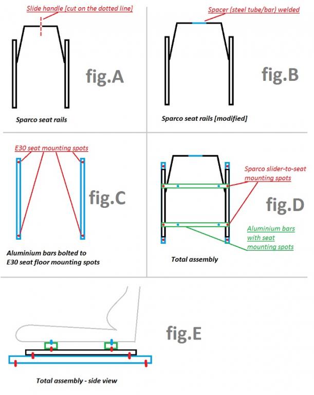

I have a set of Sparcos (R100) to put into the car, and I'm thinking about some brackets.
Here's what I came up with (behold my MS Paint skills ;)):
Basically it's an idea to widen original Sparco sliders (rails) and use thick-walled aluminium bars that would act both as bolt pattern adapters and risers. Next, two more bars to link sliders-to-seat mounting holes in which I'd drill the holes to bolt the seat onto.
By taking some quick measurements I found out it would work fine, but I'm not sure if it's a good solution safety-wise.
Any opinions (well, almost any) are welcome. I plan installing the seats in about a month, so still plenty of time to think.
