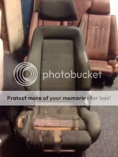

Each Recaro has a basic model number such as A8, LS, SRD. The first 2 letters stand for the back of the seat. The last digit stands for the base of the seat. For example an LX will stand for the back of the seat with its trademark pointy triangular bolsters but an LX-A will be the same back mounted to a flat base. Here is an example of a 3rd gen LX (top picture) and a 3rd gen LX-A (bottom)
Most recaros can be traced through 3 generations, each with their own specific details and differences. Example the first generation LS (known as the idealseat) has a trademark rolling upper bolsters but the lowers are very large and the slope is very close to the back of the lower frame. The later generations have a very similar back at first glance but the lower bolster foam is much smaller with the slope of the bolster midway back on the frame as seen here.
The construction of the early recaros was very primitive compared to the later seats. Honestly the biggest improvement i have found through the generations is the advancement in the construction of the seats. The gen 1/2 seats are fairly difficult to assemble where as the later 3rd and 4th generations are about as simple as you can imagine.
