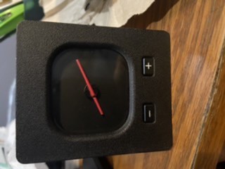

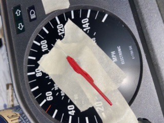

        I dont remember the exact testors paint code, but I used a few drops of their fluorescent orange to brighten up the red, i wanted a little more vivid red for visibility, not quite as dark as the m3 ones tho. Two pics with different lighting

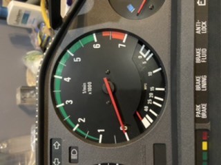

          I did some testin', hope this helps someone in the future. I didn't order the amazon paint.
          Testors Flat Red #1150
          Testors Gloss Red #1103
          Testors Flat Cherry #1197
          HiPo HP-FLRED-01 (yes, the card is incorrectly labeled "amazon paint"
          The M3 appears to be brighter than I thought closer to the flat cherry #1197, but I really prefer the darker #1150 for what I had in my mind. The lighting makes all of this very difficult to photograph, but I tried.
          Untitled by Bobbie Morrone, on Flickr
          #1150
          #1197
          M3 cluster is brighter than I remembered:
