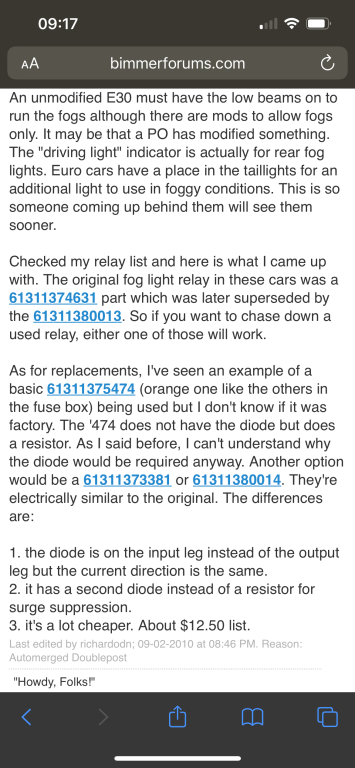

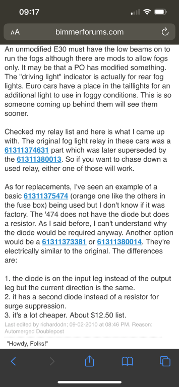

      So, I’m afraid neither realoem or google was helpful in this case. realoem lists no substitutes:
      Click image for larger version  Name:	IMG_2254.png Views:	0 Size:	75.5 KB ID:	10108156
      The one thread I found lists 61311374631​ as the part superseding the original and no direct replacements: https://www.bimmerforums.com/forum/s...ad-light-issue
      Click image for larger version  Name:	IMG_2255.png Views:	0 Size:	177.8 KB ID:	10108159
      I did notice a note that the fog lap and low beam relays are supposed to be the same. The one in my fuse box has been replaced by the 61311375474 mentioned in the thread. Can anyone confirm this works despite the structural differences?
