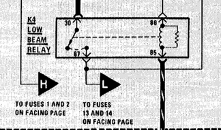

            Ohhh no power. Then I would check for power at the fuse box terminals for the low beam relay and trace it back to the headlight switch. In my experience, E30 headlight switches are pretty solid though.
            85 is the trigger from the headlight switch
            86 is +12v.
            87 goes to the low beams.
            Check 86 for power. If so, then jumping 86 to 87 should turn the lights on. If it does, with the K4 relay installed, ground 85 to simulate the headlight switch to test the K4 relay...lights should turn on. This will tell if it's the switch or not.

                So the low beams turned on when I jumped 86 to 87. Yay! So I’m assuming it’s the headlight switch, correct? Thank you so much for your help!!! Made my day when I saw those lights come on!
                • reelizmpro
                  • 9543
                  Now remove the jumper, install the relay but not all the way. Run a wire from the 85 to ground. If the light turns on then the relay is good and the switch must be bad.
