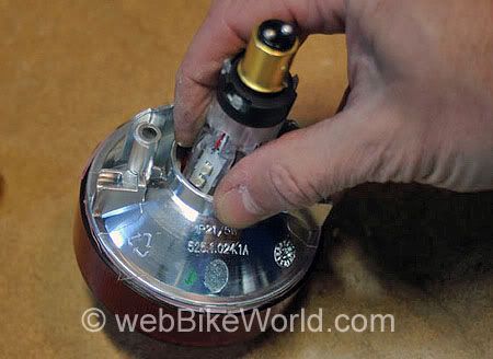

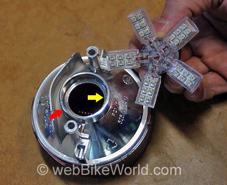

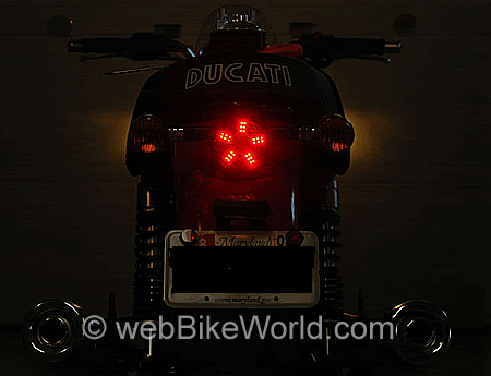

              That foldable design is kind of neat. Do you have any experience with it, or just saw it on the site?
              I've been looking for a good 1157 replacement for years, never found one. I finally just got a second taillight for my bike and am planning on building an LED board, inspired a while ago by that E30 with the led board install.
              Anyway, back to OT. Subscribed.
              • newman
                • Mar 2007
                • 1159
                The foldable one is called a spider light and runs about 20 bucks each. I may try them in my car...
