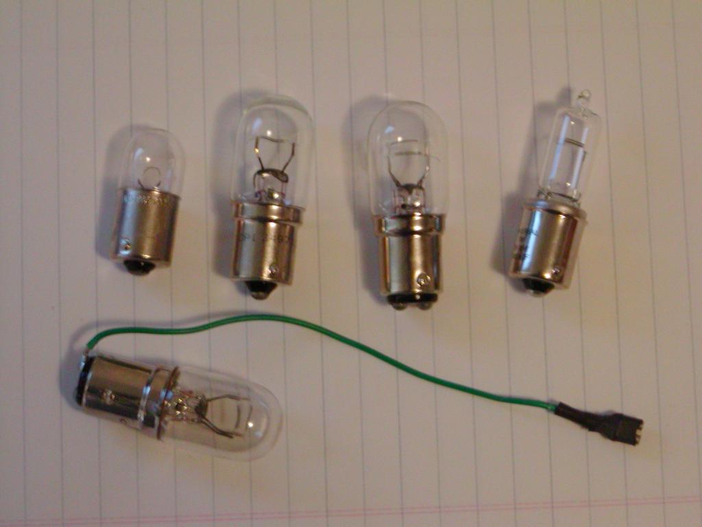

                      Here is a picture
                      Originally posted by Van Westervelt
                      I would like to see pictures of these 'items'
                      The attached picture shows High Output (HO) bulbs I use, they are available for sale individually, in sets, and as part of my high performance rear lights for BMW models E23, E24, E28, E30, etc.
                      The one at the bottom is the modified two filament bulb that provides both tail and brake lights in one location. Put that in the right place, and you can more than double the tail and brake light output from your lights.
                      Left to right:
                      R10W HO Tail light bulb, 12V 10W 10cp
                      P3497 HO Brake/Turn/Reverse light bulb, 12V 25W 45cp
                      P3496 HO tail/Brake light bulb, 12V, 4/25W, 3/43cp
                      796 HO Halogen (reverse ONLY), 12V, 35W, 75cp
                      Bottom: Mo Brighta bulb (same data as P3496 above)
                      Are these the 'items' you were wanting to see?
                      Andy
