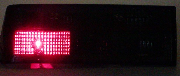

    Here is Brake light BEFORE - note purplish color

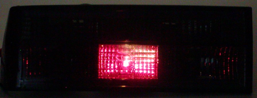

    Here is Tail light BEFORE- note color and similarity to brake above

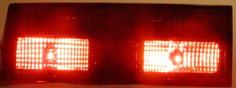

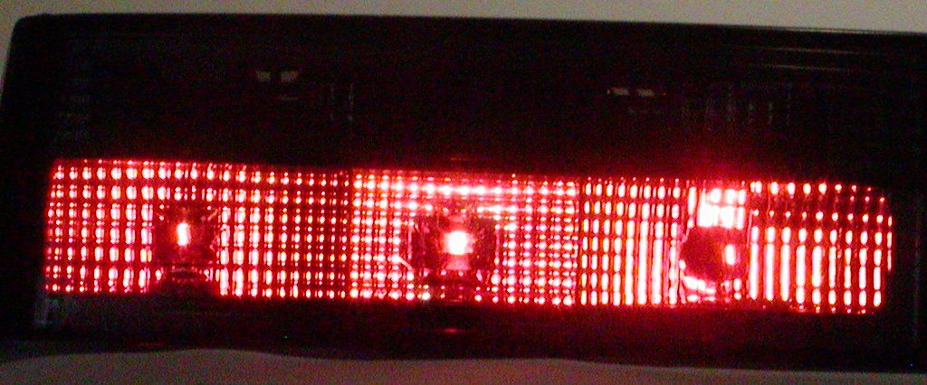

    Here is Brake light AFTER, with rear fog socket as a second brake light
    Here is Tail light AFTER, with the brake and rear fog sockets as two additional tail lights
