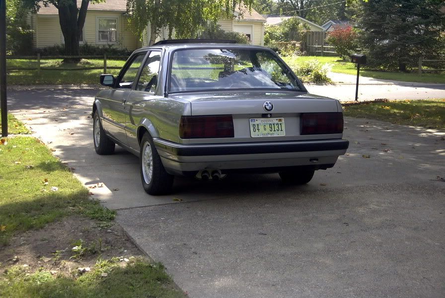

              i tinted my own with VHT tinting spray, 12.95 at Ziebart(not sure if you'll have one) 00ronburgandy00 on here gave me the idea. He did his own too on the 318 he sold. Both cars came out pretty good IMO.
              • nando
                • 34844
                maybe it's my eyes, but those look horrible. just IMO...
                  Might as well spray paint them with stright black paint.

                    Dustin, I like the look of that. How much did it effect the light output?
