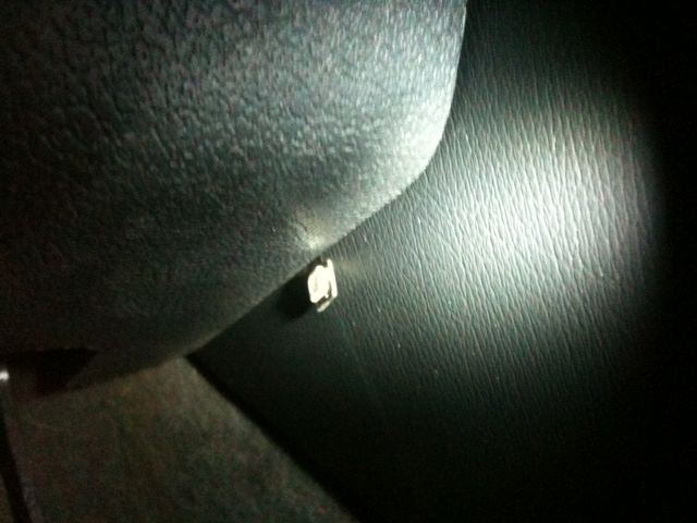

    Here is what I did:
    Opening the door: Lights in the footwells along with underneath the armrest turn on.
    Cruising down the road, the lights dim with the speedo and tact:
    Here is a link to the LEDs that I used:
    2 of each color (red & white) in each footwell & 1 of each for the armrest:
    Super Bright and Ultra Slim Pre-Wired Surface Mount 12V LED, 100% waterproof and come with a built-in resistor and a couple of feet of wire.
    Added a dimmer since the red LEDs were too bright, now I can choose:
    Universal single color mini LED dimmer can dim any 5~24V DC LED product from 10%-100% using Pulse Width Modulation (PWM) circuit push button control from stepped intensity adjustment. 5 dynamic flashing modes with adjustable speeds. Maximum load is 5 Amps - holding Speed/Bright button turns LEDs ON/OFF. Retains last setting when power is cycled. Attached 4" power input and controller output wire leads. Suitable for vehicles

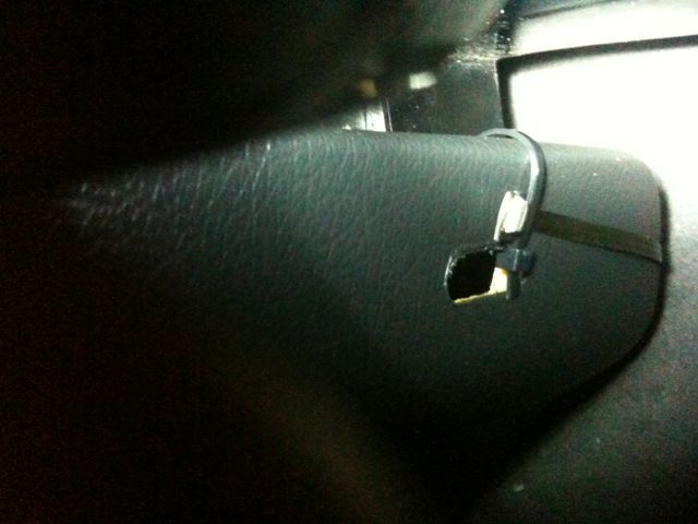

            Thanks for the tip on the dome light, I didn't consider that it has 3 wires. My set up is similar except for the white LEDs -- but I think I am going to do that, it's an excellent idea! To affix the LEDs I didn't use sticky tape because I've taken my interior apart 5-6 times in the last year and didn't want anything permanent.
            My zip-tie solution looks like this:
