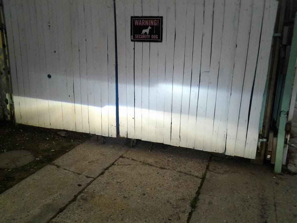

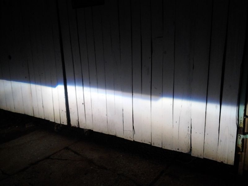

        So your saying putting a HID kit in a e30 ( 20 plus year old ) projector is the same as an e55 fx tl ap1 etc etc projector. Your very wrong...
        my FX-R vs a US ellipsoid , both HID's
        Heres a mini h1 retro I did in my GF's corolla. Can your smileys do this? Dout it.
        My smiley fx-r retro
        idk you tell their the same.

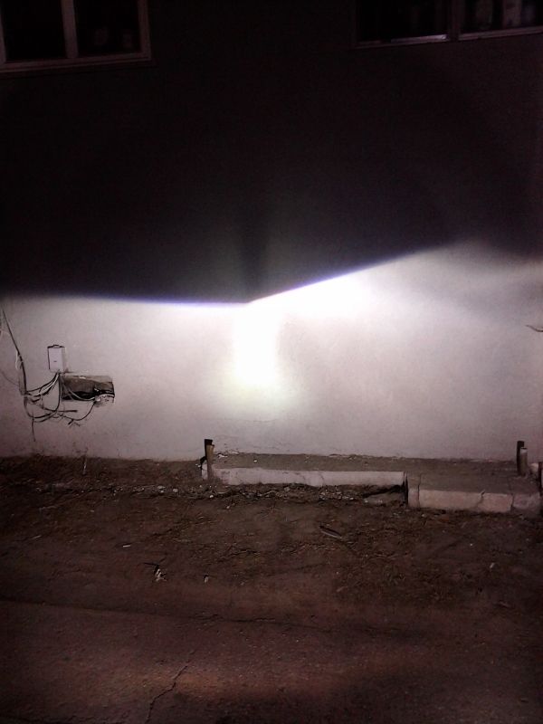

          Uh, smileys are european lights. Those pictures have distinctly US cutoffs (and poor sharpness of the cutoff, but let's not go there yet). Did you remove/change the shields?

            Well yes they are US cut offs because I think I live in the US. How is the cut off poor? and not sharp. Those are FXR and Mini h1 projectors.
            And who removes or changes shields? Got it twisted bro.
            this is the euro cut off

              Yes, that's what I do not follow.. oh, perhaps I do. You put the fx-r in the smiley, therefore the fx-r projector has a US cutoff.
