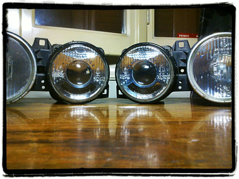

    Hello to everyone reading.

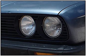

    I want to upgrade my headlights from this:
    to this:
    One of the pairs have a broken supporting frame.
    What do I need in order to install them to my E30?
    Can I use the existing supporting frames on my car?
    What about the electrical connections?
    Thanks for any replies!
    N.

    Glue the frame together, once it's on the car it'll be fine.
    You need Euro Pigtal connectors to wire these in, but not neccessary.

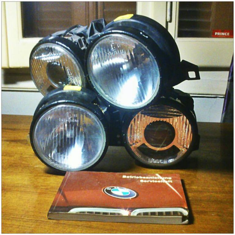

      Well,I finally got my hands on some OEM Bosch euro smileys headlights
      and went on to clean the low beams successfully.
      The photo talks by itself.
      The problem now is how the hell I can clean the inside of high beams?
      There s a film of dust stuck in the inside of the lenses of both.
      Is there any other way than baking them or cutting the glue of the lens?
      I d be grateful is someone could help me on this one.
      N.

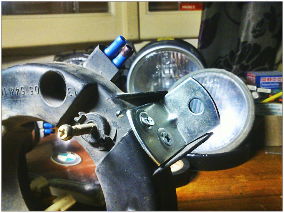

      PS. Btw,I payed only 52$ for these.Only one plastic bracket broken out of the six.
      I ll use a metal tab screwed onto the plastic frame to restore it and be safe.

        Yes, plastic foam tipped swabs...about 4-6" long dipped in glass cleaner works well. These swabs commonly used for cleaning optics, heads and such.

            Well I tried again and again and couldn't clean the mirror and the lens.I finally used water 2-3 times and now I ve placed the headlight upside down under a spot light (which gets quote warm) in order to let it dry overnight.
            I get the feeling that this was not a good idea though...
            Anyone else done this?
            N.

              I have had a light get water in it before. I ussed a space heater to dry it out. As long as the air can get out it should dry out.

                If it's a bosch lamp, green backed, then you can heat the glass up and take it off easily.
                If it's dark maroon backed, be careful, as Bosch used diffeent glue on these.
                If it's a Hella, forget it, i've broken loads of glass in the past on those.

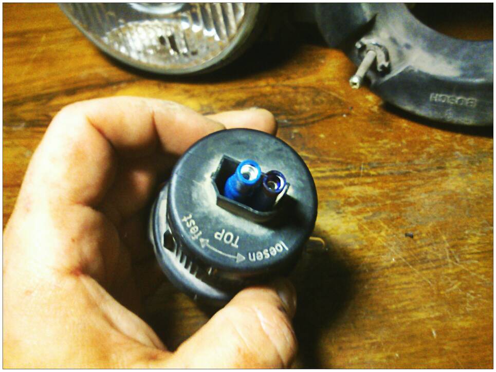

                  Ready to be installed!
                  Just need to figure up the wiring.
                  Fixed the broken tab:
                  Ready for the wiring:
                  Secured from humidity.
                  Ready for installation:
