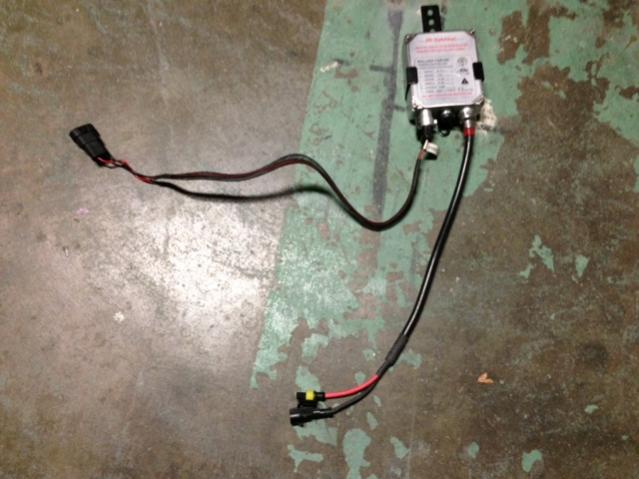

    I recently bought an 88 325is with ellipsoids and want to put some HID's in. I have some old ballasts and the 9006 plugs already. I would like to buy some Morimoto 4300 bulbs from TRS but I'm not sure if my pieced together kit is complete. I see in some kits there are relays, but my ballasts dont have any separate power wires. Am I missing something?

    You're missing another ballast. lol Other than that, bulbs are all you need. The car's 9006 connectors should be able to plug right onto the ballast, so that harness in the picture shouldn't be needed. Those "relays" you are thinking of are probably ignitors. Some kits have them internally and some have them externally.

        yes, that is all you need. power wire on the left, and the wire that goes to the bulbs on the right. some people install relays for additional safety, but you should be ok.
        just make sure you buy the correct bulbs. 9006 for US ellips or h1 for EURO ellips. 4300k morimoto bulbs are an excellent choice.
        also, i believe that if your car didnt have ellipsoids stock, you will have to do the relay mod to allow your low beams to stay on when you turn on your highs. otherwise they will turn off. correct me if im wrong.
