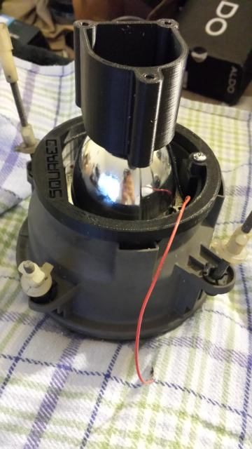

    So as a couple of you recommended squaredmotorwerks brackets I bought them for the US ellipsoids. First of all I'd like to give a huge shout out to JT @ Squaredmotorwerks for excellent customer service! My first package was lost during Christmas and JT got a 2nd set made and shipped out all on his own dime.
    Sorry don't have before pics as I think the picture would have come out black... for the sealed beams...
    Here is kind of the whole bucket with the brackets...
    The Morimoto H1 projectors come with an actuator you can wire up using your existing high beam wire from the sealed beam so when you use your highs the projector cut off flips out of the way.

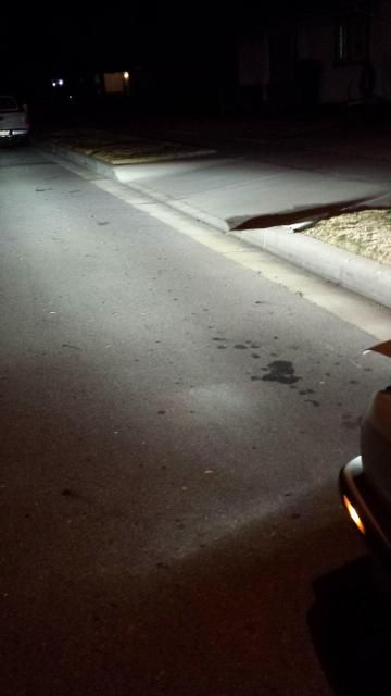

    This is a picture prior to leveling...

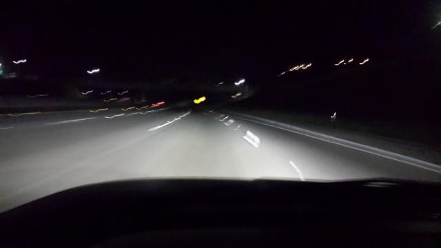

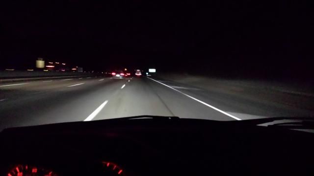

    Tried to snap some pics on the road showing how bright it really is... these parts of the freeway are actually really dark at night... especially the 2nd blurrier pic

                This is an HID kit in a "Halogen Projector". I am back around 25ft to aim headlights. The is a pretty clear cut off and only real negative is a hot spot at center.
