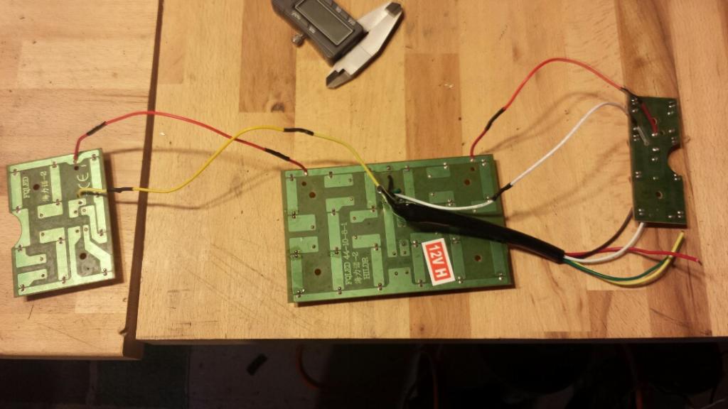

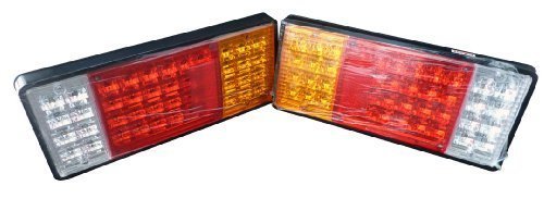

    I did this last Saturday, figured I'd throw the pics up here.
    First step is to buy this GENSSI trailer lights on amazon prime for $30. Make sure to get the 12v version.
    Then disassemble everything. The lights come apart easily, just some screws. Luckily all the LED boards are separate. You'll need to extend the wires.

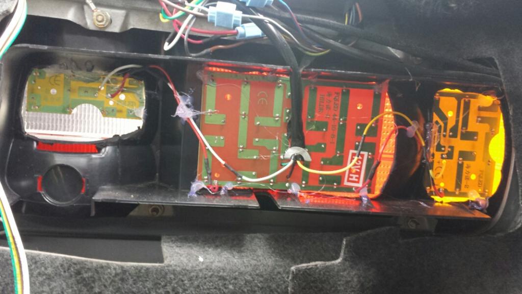

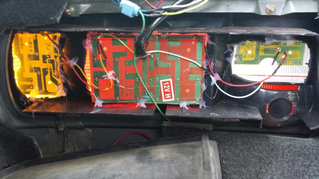

    Then cut the taillights to accommodate the led boards. I went overboard on the reverse, oh well. Hot glue them in place. Ignore the splices, they're for my trailer hitch.

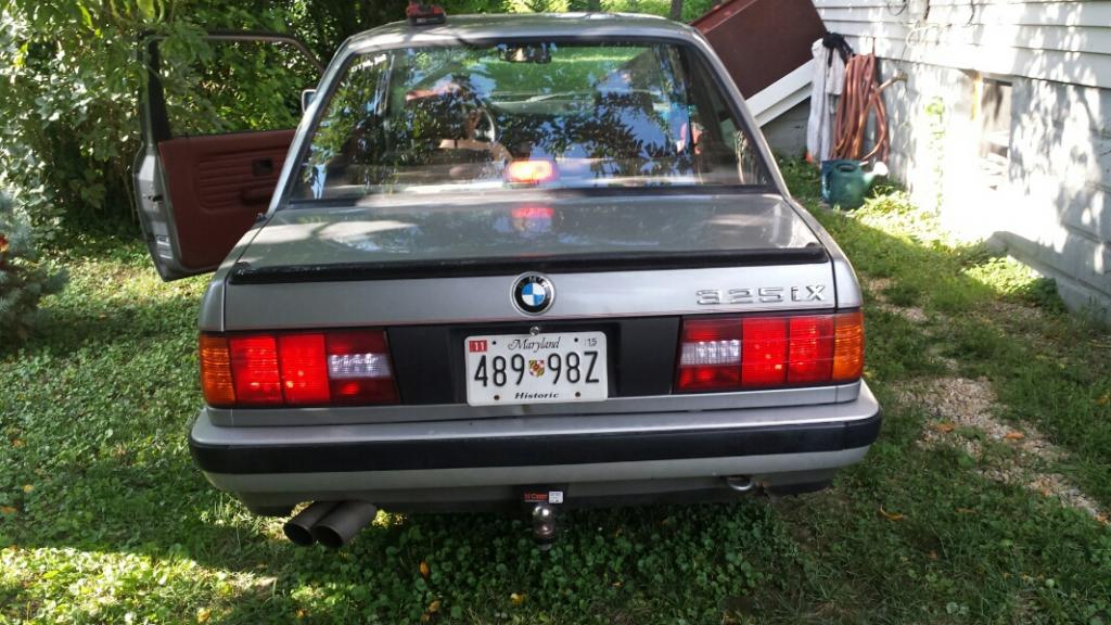

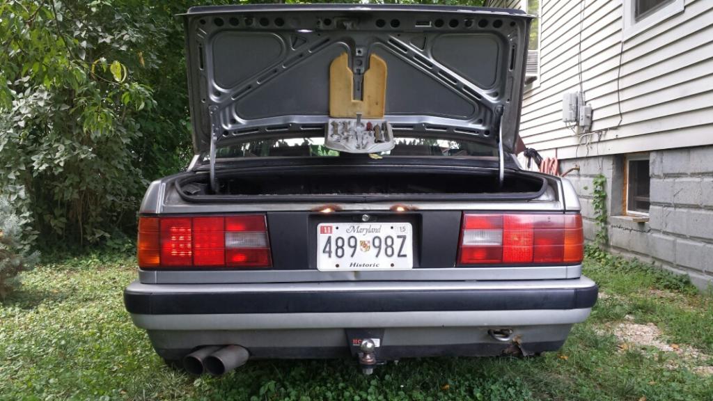

    Comparison pic. Driver's side is LED, passenger's side is OE.

    All lights on. This is direct sunlight. They're quite a bit brighter than stock.
    Night time.

        would be interesting to see a side by side night shot.
        • Kershaw
          • 11822
          I think the biggest thing is that both the taillight and the brake light area pull double duty for each other now, so you get twice the brightness there. I'll see about getting a night comparison.
          AWD > RWD

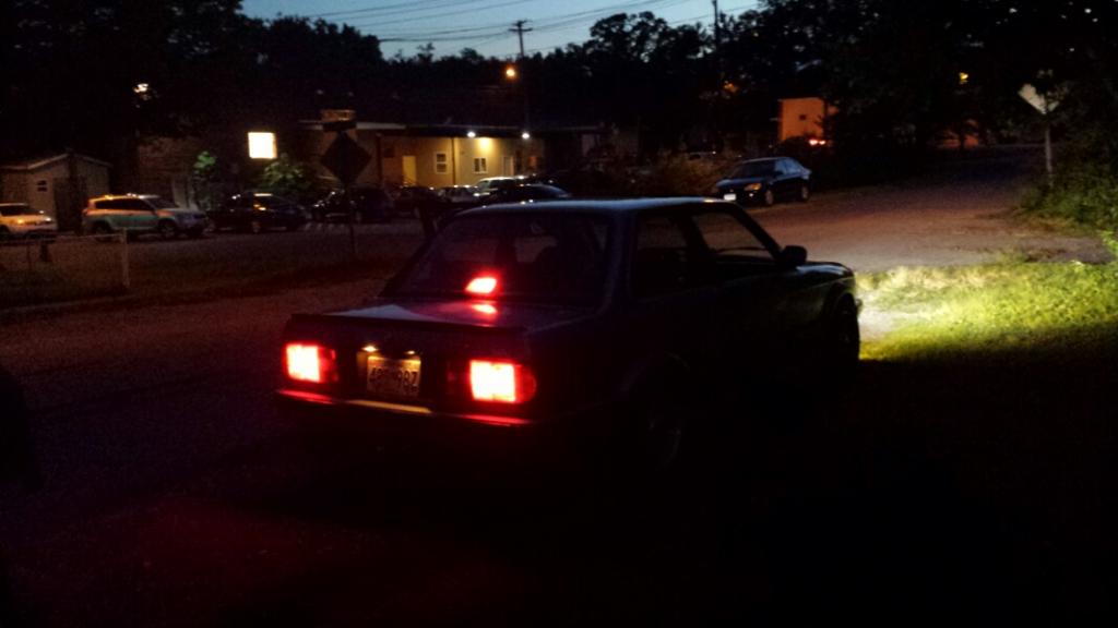

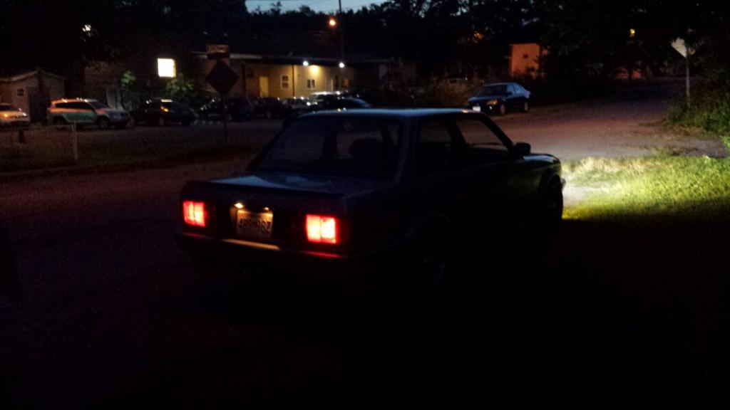

          • Kershaw
            • 11822
            Adding 50w 6ohm resistors to get the blinkers to blink properly and remove the brake and tail failure lights on the over head check panel seemed to have dimmed the lights significantly, as in OE is now brighter. Oh well, at least the tails are still doubled up. Bit of a fail at the end. Might search for different LEDs for the blinkers or double up the amount.

            • AndrewBird
              The Mad Scientist
              • 11897
              Get a solid state flasher. No resistors needed.
              You can modify the check control module as well. Luke talked about it in one thread I think.
