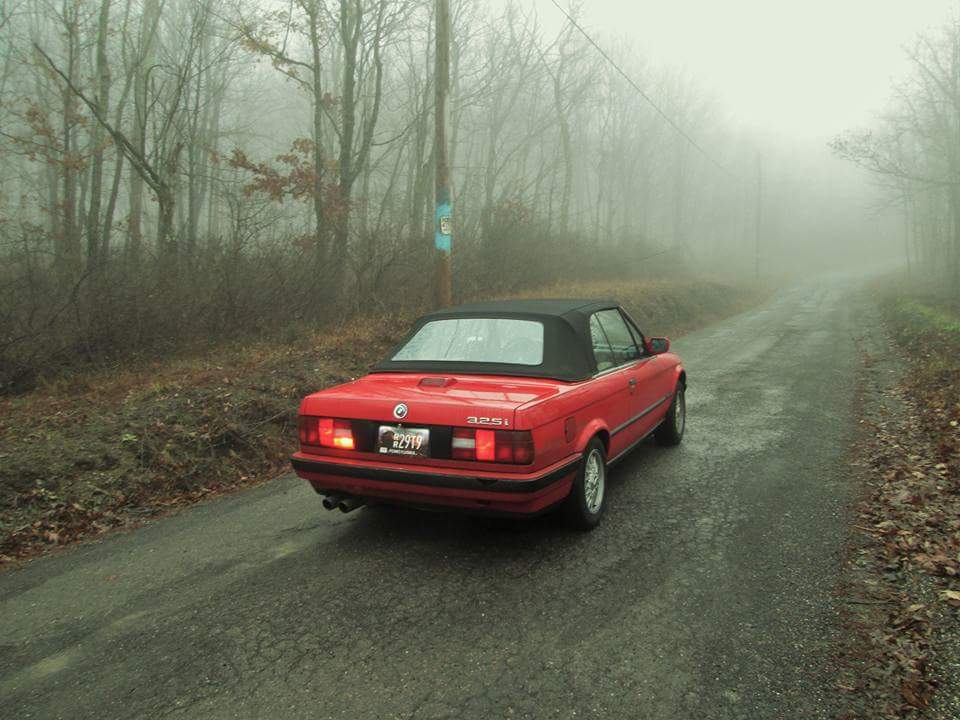

        I've wired one up in my current e30 and have in my past two also. Like said above most don't know what it is and is confusing to them. But with that said, they have noticed you cause of the confusion and wondering what it is. Its a steady constant bright red light (looks like a stuck brake light). You only use it in heavy fog, rain or snow. If you don't live in an area with these weather conditions, then another brake light would be best for that spot. I would like to get a set of export tails for my Jeep Cherokee and put the rear fog in it also.
        The stock US tails don't have the reflective backing in the spot for the rear fog, so I used heat duct tape since it is chrome like and will reflect the light in the housing.
