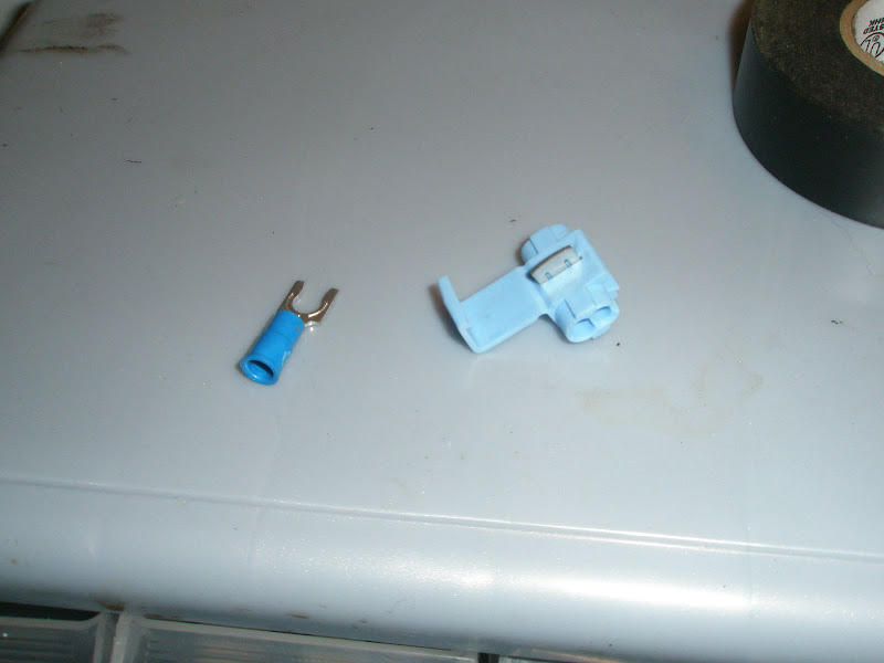

    First access underside of fuse box, then get your self these two dudes, male split spade and quick connector

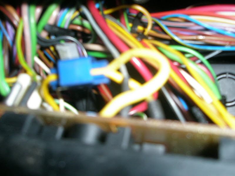

    Next you go under the fuse box and find a yellow wire that goes into the underside of where the relays are (it has been yellow on all three of the cars ive done) it is very close to the 12V terminal as well.
    You then take a short piece of wire, attach the spade, put it inbewteen the nut and the underside of the fusebox circuit board and then use the other side along with the quick connect on that yellow wire,
    Like SO:
    And now you can run rally style, fogs,highs, and lows all at once

                  Yup. I figured this out through wiring diagrams just like everyone else. Just realized that that yellow wire is for the fogs and it unloads when you turn on the highs, i simply supplied it with 12V so it wont unload.
