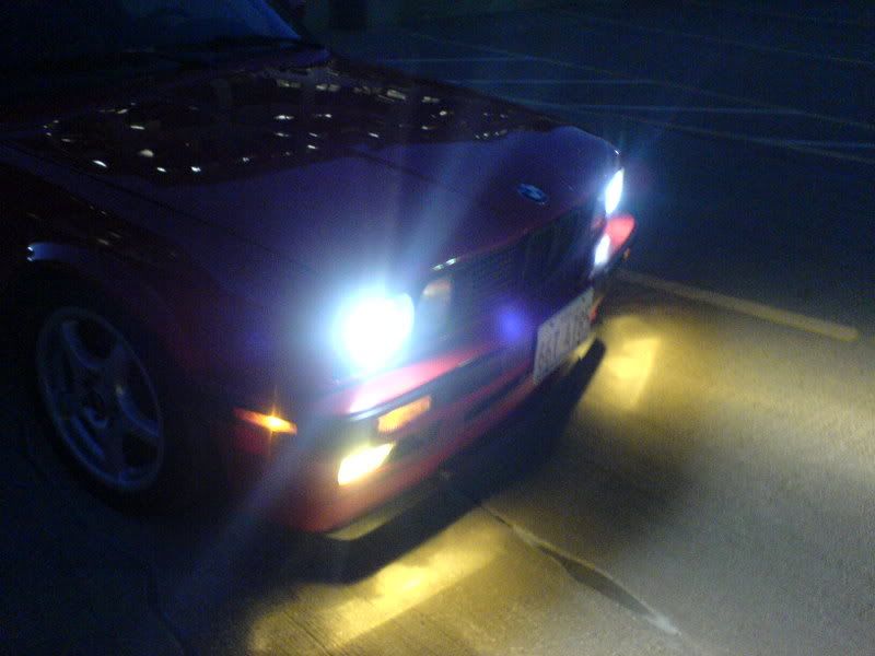

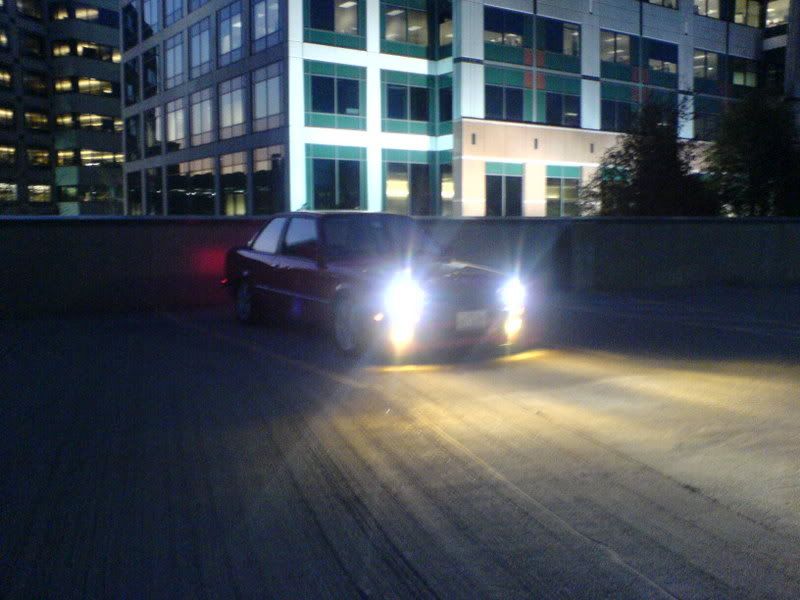

      You need H1 base bulbs to adapt into the euro housings. I have the apexcone 55w kit from understeer.com with 4500k bulbs in my smilies; it looks like a factory BMW setup, and is quite bright. Here's some pics, but they actually look less blue and more white in person than in the first pic.

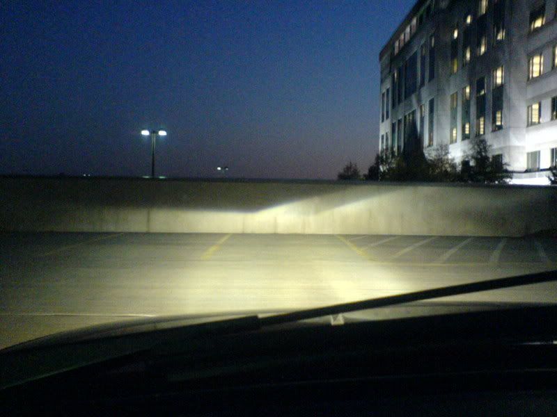

      Here's an idea of the pattern and light flood for those who haven't seen.
