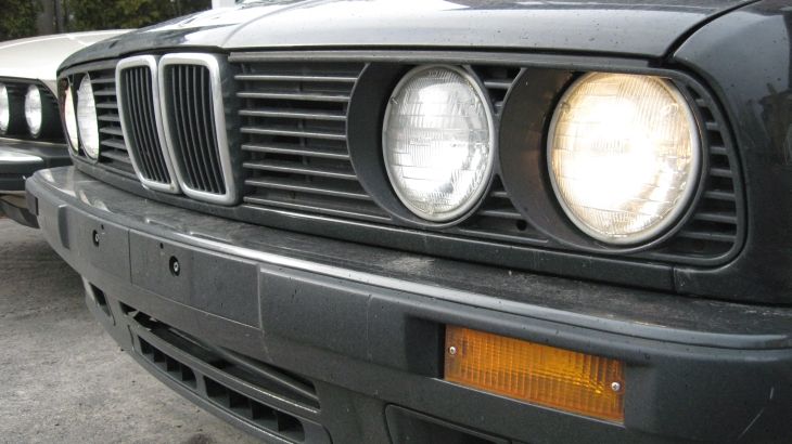

    I have a '91 325i, US-Spec, but has daytime running lights(Mandatory in Canada >1990)
    I recently bought a pair of Bosch euro smiley ellips.
    They didn't come with connectors but they did come with high beam and city light bulbs.
    Instead of low beam bulbs, the guy sent me an HID kit(35w 6000k H1).
    I'd like to know how to wire my city lights as DRL's, because they're currently set to my low beams..
    and ofcourse how to wire the rest of the lights.
    Yes, I've searched and have found the wiring for ellipsoids and HID's separately but none have had to go through re-wiring DRL's or both at the same time...
    Help would be greatly appreciated.

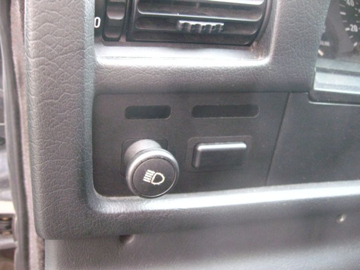

                  By the way, on the knob, theres 0, 1, 2.
                  0 being all the way in,
                  1 being half way,
                  2 being all the way out..
                  There should probably be a difference between 2 and 3 but for some reason, there isn't...
                  The sidemarkers and instrument lights both light up in those positions...
                  you can have the keys to my hunk of 20+ year old West German steel when you pry them from my cold dead fingers.
                  • JasonC
                    Site Manager
                    • 14451
                    It should be
                    0= off
                    1= parking lights+instrument lights
                    2=headlights+parking lights+instrument lights

                      Well my headlights are on all the time, hence them being DRL's...
                      The car's originally from NJ, and was brought into Montreal..
                      I'll check the records to see what work was done for this
                      • JasonC
                        Site Manager
                        • 14451
                        Wonder what they screwed around with to make the headlights stay on all the time then?
