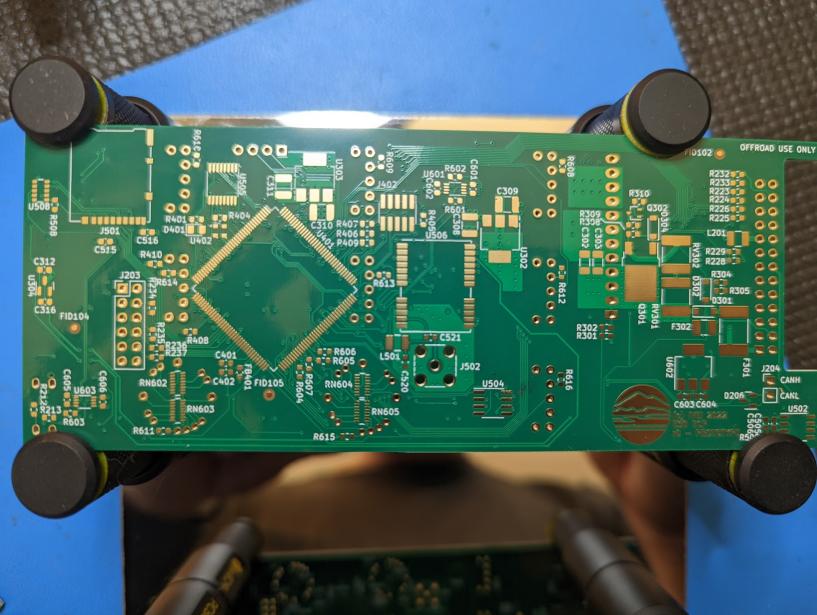

    Not really - here is a snapshot of the backside of the two boards:
Name:	Screenshot from 2022-06-19 11-50-27.png
    As you can hopefully see, there are some minor differences aside from the colour. These primarily come down to signal integrity, automated assembly support, and lots of other details that I am happy to get into if anyone is interested in but otherwise I will save you all from being bored to death. Long story short the R1 board (white) is much, much more difficult to debug but should be much more robust as a device in the car. The R1 board will likely also undergo some minor changes before being actually ordered, but this will be based on testing done on the R0 board that I should have in hand shortly.

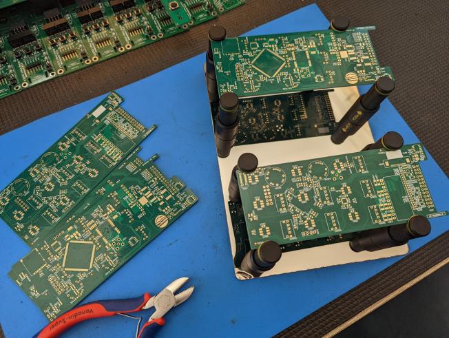

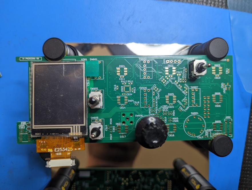

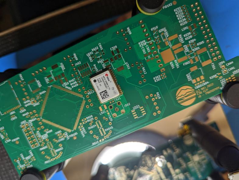

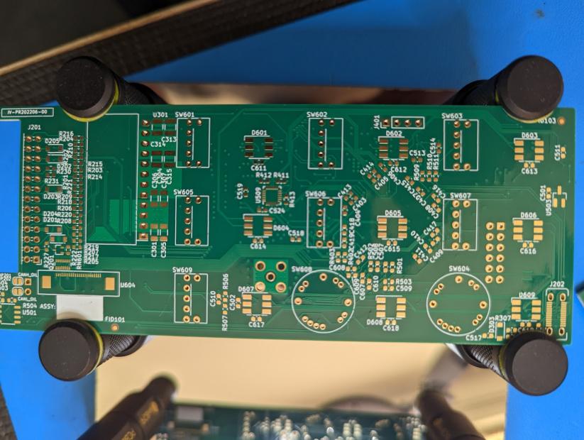

                  Bare prototype boards arrived today. I don't have time to start the assembly yet, but I hope to tackle it before the long weekend (or at least get most of it out of the way so I can get to basic electrical validation next week). All the new footprints check out OK, at least mechanically. These are super quick and dirty but I am reasonably happy with how they turned out, especially given the time involved:

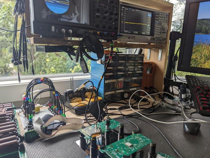

                            I have to agree regarding the metcal unit - extremely happy with mine, but CV stays off as I just find it annoying. I guess if I ever have an intern working out of the house it might come in useful for a bit, but that is rather unlikely:
                            I usually solder 0.5 QFPs, sometimes under the magnifier, with a fine tip (either a conical ~0.4 or a chisel tip held sideways). Hoof may be easier but I don't have one and have not tried it. The trick I find is to just use a very tiny amount of solder - so you need a very fine solder gauge. Do that, with plenty of flux, and it goes very fast. It is unusual for me to even bridge a pin on a 144-LQFP anymore.
                            For inspection, I would very highly recommend a cheap USB microscope. It makes spotting bad joins so trivial the $40 or whatever they cost is well worth it.
