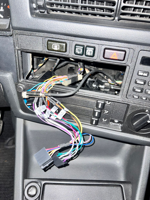

                        He sent me an image of the wire harness behind the radio delete panel . Do these look original?
                        • kronus
                          • Apr 2008
                          • 13032
                          That’s an aftermarket adapter wired into original looking twisted pair speaker wire.
                            who tf specs an e30 with a premium OBC but no radio??
                            kronus Definitely an oddball spec. But thanks for pointing that out, hopefully that adapter kit works!
