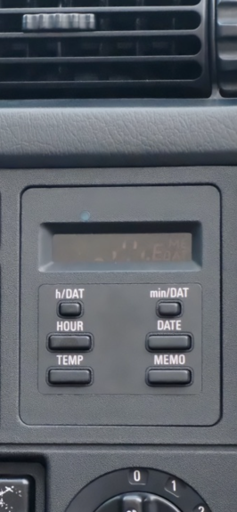

    The 6 button on board computer in my 92 318i is acting up. It flickers and jumps around to what seems like different modes. What might this be an indication of? Is this something that’s repairable or is replacement the right way to proceed? Click image for larger version

    the lcd screen is probably in fail. might be able to find an aftermarket replacement screen, but swapping the whole unit out is going to be easier.

      When this happens in mine i flick between the columns of buttons and then its fine for the rest of the drive, lol

        Same on my 91 318 finger flick will fix it, if you don't like back to the future look.

          I should have posted a video. This isn't static- it's jumping around activating all of the pixels with the time sometimes visible. My kids say it's like a futuristic disco party or something. Anyway, google led me to a repair service which seems to be cheaper than what people are asking eBay. I guess I'm trying to figure out if this is, for sure, a problem within the OBC and not caused by some other failure further upstream.

            I think your issue is something else. They repair the pixels from what I understood from the advertisement.
              it will be the obc itself. your inputs are probably ok.
