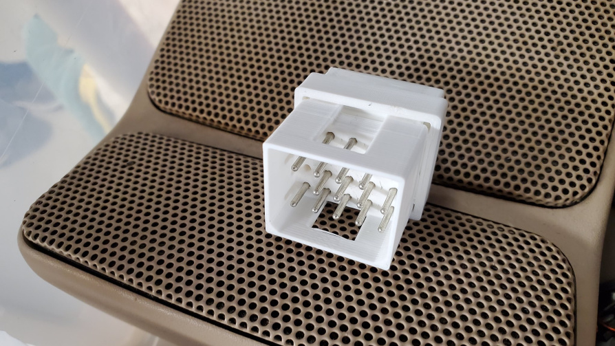

      Thanks! I gave the tape play function a try but still no sound. Is this the bypass adapter you mentioned? I don't think I got it from you, but it may do the same thing... I'll have to mess around with it this weekend.

        ha cool that's Ryan's adapter. I ended up going with my own design as the pins he was using cost $2 a pop and are overkill for the application. I have a pre-wired bypass adapter that costs less, plus a bunch of different access harnesses. If you just want to test then yeah you can wire it up or I'll send you a loaner.

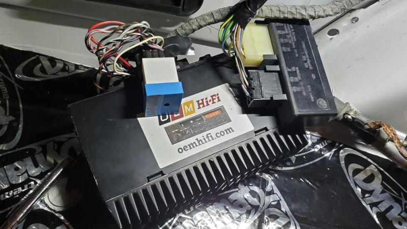

            Hey Bradnic, I got your bypass adapter, and it worked great. Would like to get the amp looked at by an expert. DM'ing you to coordinate a hand-off. Thanks again for your help!

              This is exactly why I do loaner bypass adapters - give folks a chance to know if wiring or equipment is the main issue. It's quite unusual for the OEM trunk amp to 'click on' and you not have any sound output on any/all channel(s). That is almost always due to a no power situation. The only other wiring explanation I can think of is the radio output ground wire being cut, but that would still likely produce some sound. Looking forward to getting the amp on the bench.
              Vincenze's post above is spot on regarding the potential root cause here. A bad relay winding could explain the behavior you've seen - relay clicks on but no sound because the amp internals aren't powered properly.
