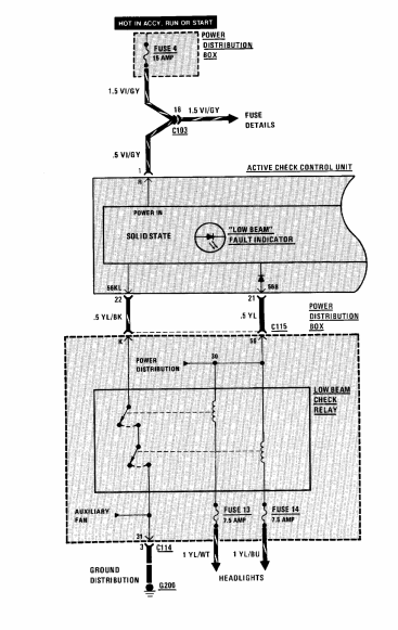

          Well based on that other thread I poked around in the module that I found in the trunk on the left side for quite a while with the multimeter and I think I came to the conclusion that that module does not contain the "low beam check relay" in the wiring diagram.I don't know where to find it and searching the web has been fruitless.

              Well it says there it is located inside the fuse box.
