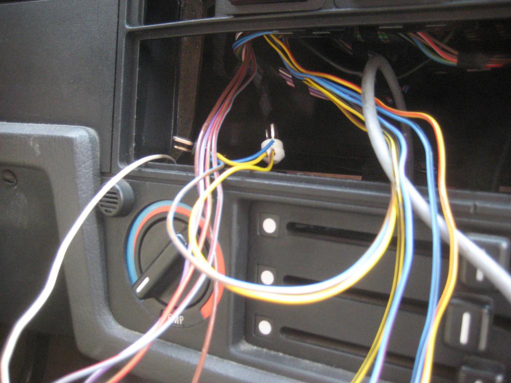

            I'm trying to separate the grounds for my new speakers in a 1985 325e, but the splice point isn't within reach. I follow the common grounds (YL/BRN & BU/BRN) as far back as I can but don't find the splice points. (I've opened the big cable tie). Any ideas?
            How hard is it to further dismantle the console/dash to be able to reach further?
            If I have to run new wires, what's the easiest path?
                If you are only doing speakers, it does not matter.

                • mbarthelow
                  • 4
                  I put a new head unit in as well.
                    Post a pic of your wiring, please.

                    • mbarthelow
                      • 4
                      85 325e speaker wiring
                      Here's the wiring. The 4 positive speaker leads detached from the fader are to the right across the antenna cable.
                      The YL BRN & BU BRN leads are next to the left. You can see they still have the connector for the factory stereo, but I've clipped the blue & yellow positive leads that formerly went to the fader.
                      thanks!
                      Michael
                      • StereoInstaller1
                        GAS
                        • 22679
                        That sure looks like a premium sound harness.
                        You cannot do the trick I described above to an amplified system.
                        There is a cheap trick to make the factory amp work properly with an aftermarket deck, but 99% of the time, a rewire sounds better and is pretty easy.
