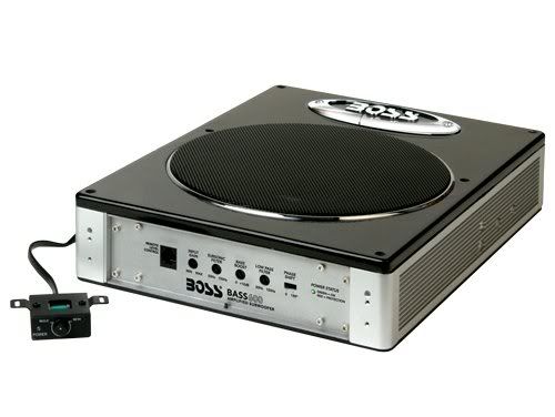

            Has anyone tried one of these?
            [IMG][/IMG]
            Dimensions: 9.8" x 2.8" x 13.7"

              ^ewwwwww.
              If you want a shallow, might as well sprint up to 10" elemental designs which is under 3" and needs only .3cubic. Granted it is not your sound quality pick, but what do you expect from a speaker with hardly any magnet.

                I was kind of assuming Ewwwww as well but I have no personal experience with this type of sub. I expected it to fall into the too good to be true category but wanted some confirmation before writing it off. Do you have direct knowledge of Boss sub?
                The elemental design you are referring to I believe is this the one below. Has any tried to make it work?
