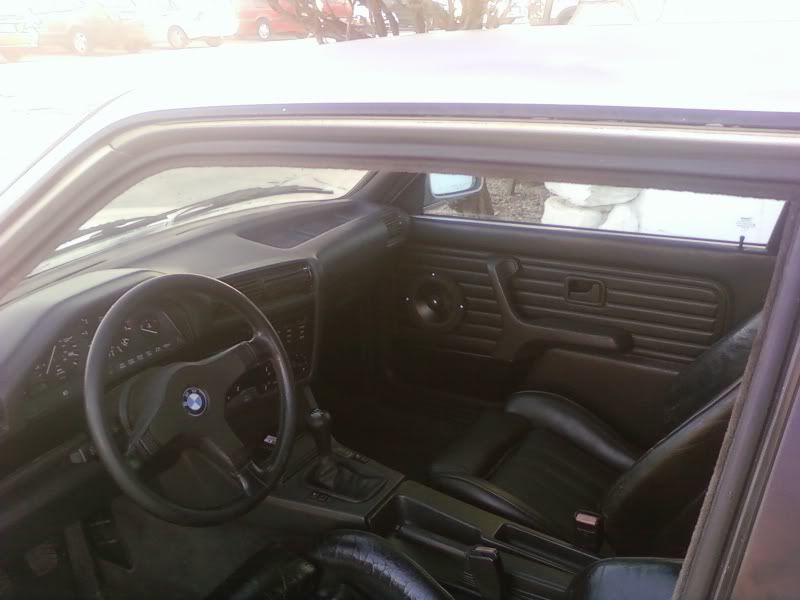

    Here is a pic of the cut made to fit speaker. A Dremel will suffice for the work, if that is all you have.
    If doing this job, or you are passing wires through the jam into the doors for any reason, get yourself one of these. They are life savers. Look like a screw driver, but are made to pass wire through grommets... and for situations like these.

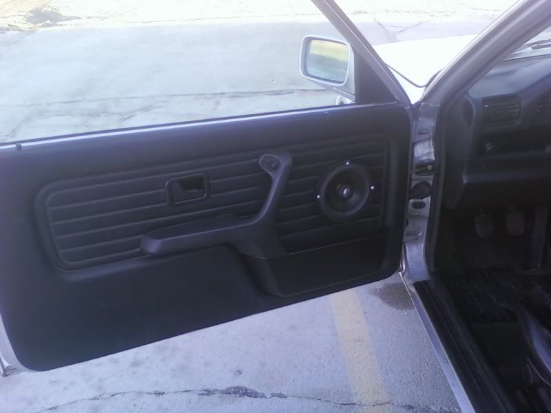

    Still need to get some speaker covers. The mesh that came with the JLs is gone, as I didn't use it when they were in the Miata. Once I have something there, it will hide the 3 silver screws. You may not be able to see the 1/2" spacer I had to add to clear the window. The JLs have a pretty decent size magnet, and were interfering with the window if just flush mounted.
    And a shot of the passenger side for good measure.

          Not sure what you mean by, "sit flush against the baffle". As for the door cards, I first lined up the speaker on the door, sans card, to find where it would fit, and not hit anything. I adjusted that until I got it to the point where I would like its final location once mounted. Once that was done, I put the card back on loosely to figure out where on it, the speaker would go. Then I traced the speaker's outline onto the card. Once traced, I cut the card a little over 1/2" inside the traced line. I then remounted card, and traced the hole onto the metal of the door, for the final cutting. For the second door, I laid the first card onto the second and traced the hole. Then rinse and repeat on the second door.
          The speakers, themselves, do not sit flush with the door card. I have a 1/2" spacer between, so that the speaker magnet clears the window while it is in the down position. Wouldn't have mattered if I mounted lower, still would have hit. Other speakers might not have this issue. All depends on mounting depth.
          Yesterday, I ran by a local stereo place where I know some of the guys. Got a couple of speaker covers for the cost of two Monster energy drinks. Fair trade, I would say. A little thicker then I wanted, but the same style. Will definitely do the trick.
          Overall, still very pleased with the setup. If you have the late model doors, and were thinking about doing this, go for it. I highly recommend. The amount, and range, of the mid bass is much better then before.

                I am very sensitive to highs. In fact, the tweets that are in the JLs, are facing down and away from me, for that reason. Hurts my ears. I usually will dial the highs back on the head unit, as well. I am pleased that I don't have to as much as usual, with the tweets aimed away from me. Still crisp, just not ear bleeding. ;)
