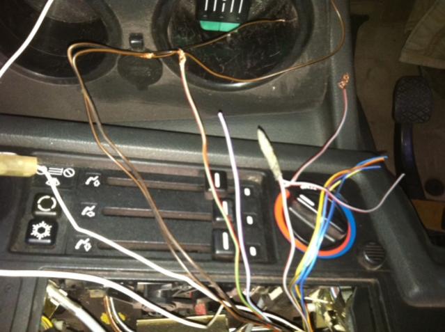

    replied
    My brain hurts
    So here is the plug from my fader. Don't see any twisted pairs. Are they behind the gauge cluster? This is a 88 vert. I have:
    blue/red
    solid blue
    Blue /black
    Brown black that has four connected together
    yellow/red
    Solid yellow
    yellow/black
    Gray/red that has four connected together
    See pictures of wires
    What do I do now

  • ncsubowen
    replied
    Edit: 1987 325e
    So, I spent my afternoon in the car and failed to do much more than get the fader harness cut off and the stock stereo removed. From here, I'm at something of a loss.
    I was not able to find the amp in the trunk (the only thing that was attached behind the antenna was the lamp control). I do have a fader, as mentioned above, which I have removed.
    Here's the picture of my setup as it stands. I don't really know where to go from here, as it appears that I only have 6 wires leaving the fader, and I can't locate the amp in the trunk.
