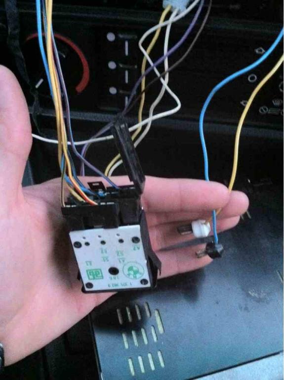

  • StereoInstaller1
    replied
    Originally posted by Wardie View Post
    So, Luke after I called you twice I kept staring at it more and more and my brain turned off. I went out and bought the 50' of cable. From here I go ahead and run wire from the deck to the back of the amp correct? My brain has a habit to forget information when hungover and half asleep. Just a preemptive sorry for making you repeat yourself more than once. Car is a 1985 325E, no amp, fader.
    Heres some pictures for fun:
    Stupid early model always making things difficult.
    I feel like I am over thinking this way to hard.
    NO!!!!
    OK, here is the deal: you connect the back speakers to the front speakers behind the deck, then cut into the speaker wiring behind the back seat.
    You are in the wrong thread! You need the $500 stereo thread....
    Luke

  • Wardie
    replied
