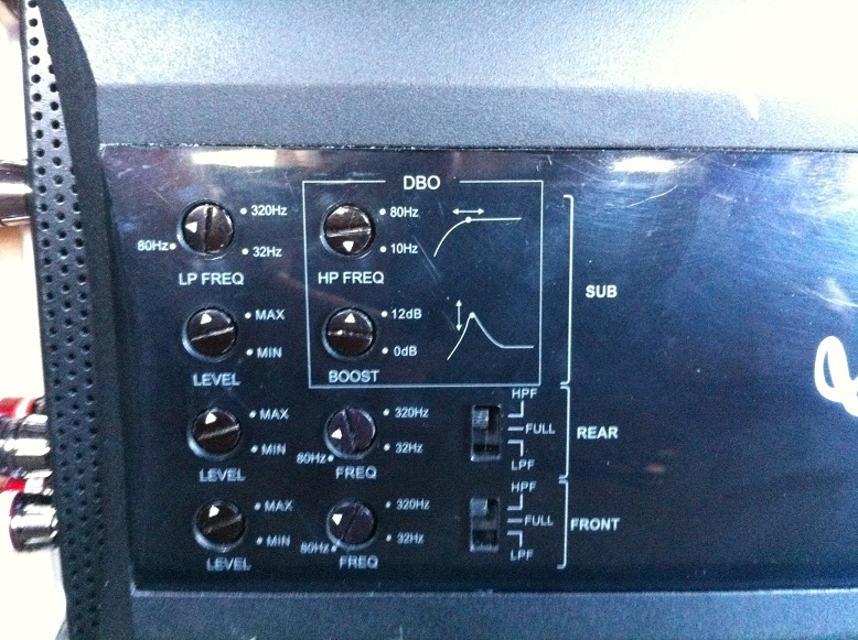

                Ok it has been a long time since I setup an amp so here is what I am currently running for settings. If it is all wrong please tell me how to correct it.

                  I would turn DBO to zero: artificial bass boost is a bad idea on a vented box. Maybe 3db, but off is best.
                  Turn the sub level to MAX, drop the rear level to allow better balance so the front stage is more prominent, maybe drop sub LP crossover point to 80Hz.
                  That amp should power this thing just fine, unless you are truly aiming for serious loud.

                    The DBo may have been the culprit but I will give it a day or two to test it out. Adjusted to StereoInstallers1 settings and it sound great we will now see if it kicks into protect. I also put the front at 99% and the rear at 80% to adjust stage.
