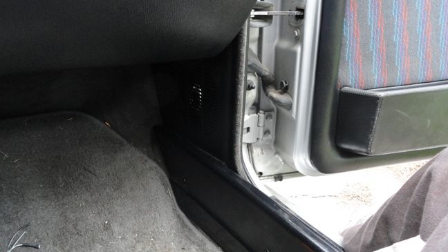

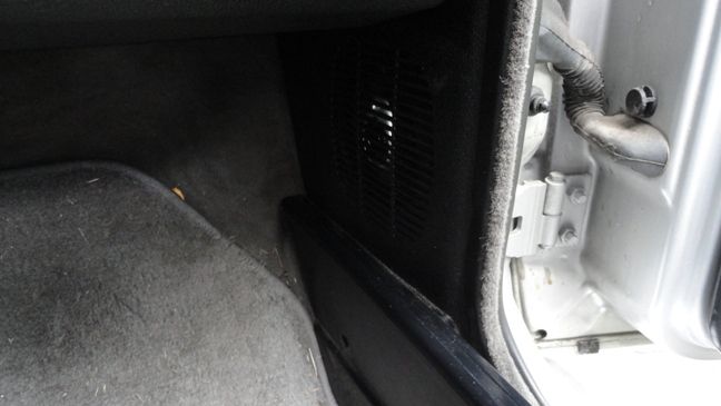

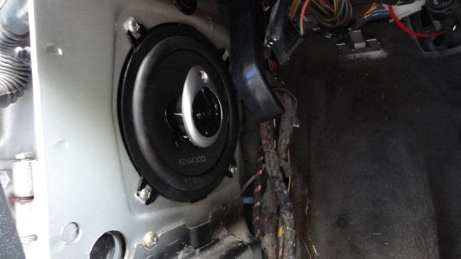

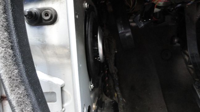

    I ordered a set of Kenwood KFC-1393PS 5.25in 3-Way for just $23 shipped from ebay (link below). The tweeter and mid does protrude, but it will fit easily behind the kick panel without any modification. Nothing is compromised. Door tweeters still sound great. They sound incredible for the money!!!! I do have a high pass filter on my stereo, so they don't play much bass car (I have subs), but they do sound great. My car came with pioneers installed in the rear, but these sounded so good I ordered a second set, I will let you guys know if they also fit in the rear. My e30 is a vert, but I think they all use 5 1/4.

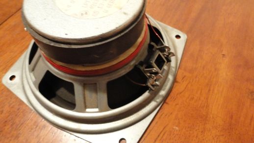

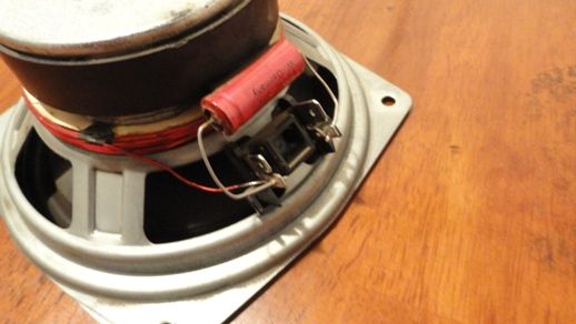

          Here is the stock speaker.
          This side had one small wire going to it, which was the ground
          This side had two wires going to it, one for the speaker and one for the tweeter. I'm assuming the one with the smaller connector leads up to the tweeter. I spliced the two on this side together connected to speaker positive.

            It looks like your speakers aren't totally sealed against the metal in the kickpanel, if you seal that up you will notice a big difference in sound quality.

              They fit in the rear and really scream. I can crank my Head unit to max and they won't distort.
                  Thanks for confirming they fit in the door rear panels.
