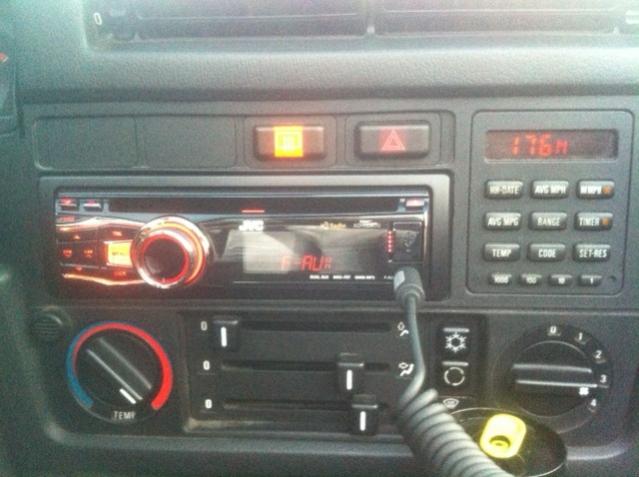

                I installed my HU today. I really wanted to wait until I got my box from luke to do the whole thing but I got tired of looking at the box in my office - plus I woke up early today and felt inspired. This particular unit has 2 sections on which you can change the color independently. I got one side to match the stock amber perfectly and then decided to try the whole thing in one of the preset amber colors. This is a bit bright so when I have the time and it's dark out I'll tune it down a bit. It can (as far as I can tell) be made to match really nicely. It sounds great on my stock speakers - I can't wait to install my components and dual 8'' subs. FWIW I bought this unit because of the color changing ability, the 3 sets of pre-outs and the USB/aux front inputs. I think it's still a bit modern for the car but for the price it is worth it. Sorry for the cell phone while driving pic.
