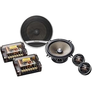

                              • Cabriolet
                                • 9620
                                i ordered "Pioneer TS-D1320C 5.25-Inch Rev-Series 180-Watt Speaker Package" for my front's today. to match the ones in my rear.
