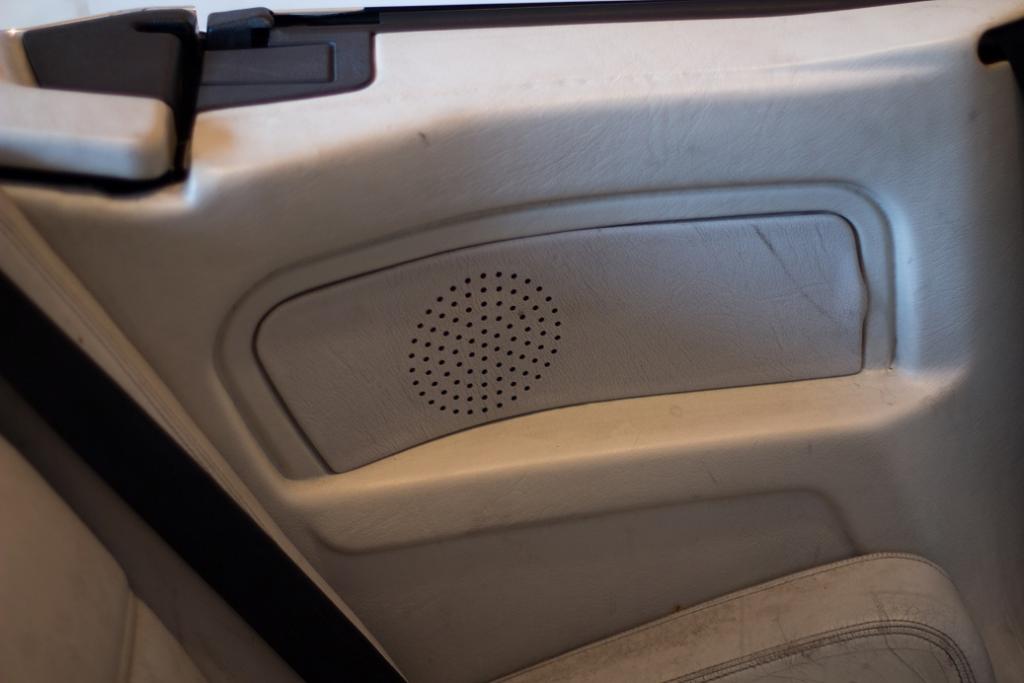

      Originally posted by German Audio Specialties
      Which ones? Sorry, have lost the ability to actually read a thread...
      If they are Premiums, they do fit, they are just a "wiggle into place" deal.
      Which premiums do you mean? Front stock premiums can fit in the rear spot?
      -MM
      • German Audio Specialties
        • Feb 2012
        • 374
        #33
        -MM
        Well, yes. The tweeter can be glued to the grille, bu it is not at all necessary fopr the rears.
        The mid needs a little modification to make sure it is not running through the choke coil that is mounted on it (the inductor wrapped around the magnet), but that is just unsoldering a wire and using it.
        To mount them sucks though. Basically, you partially remove the panel, shove hte speaker in under it and reattach the panel, then you screw the speaker in, using the stupid little "tinnerman" clips. It is a pain in the butt, and honestly, when you have a proper high pass filter on, it really is not that big of a deal. Pretty much everything sounds the same when flapping in mid air, right?

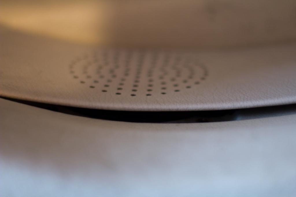

                • Cabriolet
                  • 9620
                  #38
                  you can tell then you look down on them that they dont fit but from the side, not bad and for the quality of sound they are very worth it.

                    #39
                    SWEET! Thank you, this is the absolute #1 first choice for you 'vert guys.
                    this series of Pioneer is not the typical wal-Mart bullshit, these actually do sound good.
                    The locations still sucks balls, the thing is flapping in mid air...but I do have a solution coming in the future for that.
