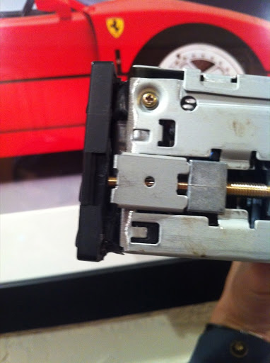

    8.) Remove 2 clips at base of threaded brass install rods. Completely unscrew rod with BMW/radio tool and set aside.
    9.) Use a 5mm x .8mm die to extend the threads on this screw. I stopped just slightly from the top in order maintain a shoulder for the spring to sit on per the stock configuration.
    10.) Completed screw, spring, and securing c clip shown:
    11.) Next grind the tabs that protrude when the brass screw is tightened. This needs to be down as it will bottom out if not done. Modifided vs non modified:
    12.) Knock off all tabs on the cage of the radio. Make sure to grind the tabs on the inside where the securing screws are located, the tabs on the top, sides, bottom, etc.
    13.) Reinstall modified mounting screws, tabs, c clips, etc. Reaffix 'face' and 2 screws. Test for binding.

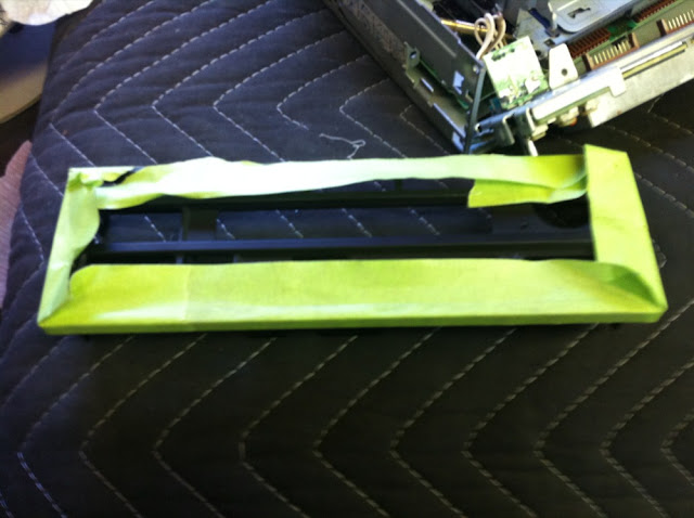

    14.) Now modify the plastic bezel. Tape along the edge in line with the mounting tabs on the side. Remove illumination plastic. Use a cut off tool to trim the outer lip all of the way around:
    15.) Use a flat disc to grind smooth all of the way around bezel. There are 2 securing tabs that hold the tab doors in place. These will fall out. Grind smooth.
    16.) Lightly glue securing tabs. Dont use too much glue, it could seep onto doors.
