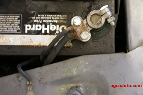

                  ^Those felt washers soak up battery electrolyte and hold it against the terminals, and are complete garbage.
                  OP: your battery is burping acid from the caps, fucking up your terminals and your battery tray. The battery's ability to absorb a charge from your alternator is diminished thus exposing it to an elevated charge rate which is boiling it over.
                  Also, do you have the temporary style cable clamp ends?
                  • Ryann
                    • 3350
                    They are complete garbage.
                    • Ryann
                      • 3350
                      Shitty connections cause rapid oxidation of electrical connectors.
