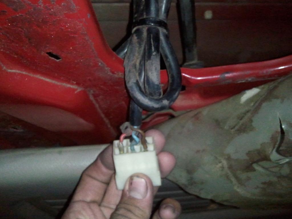

          It's also worth taking a peek at the connector in the door jamb.
          They have a habit of turning green and shitty over time.

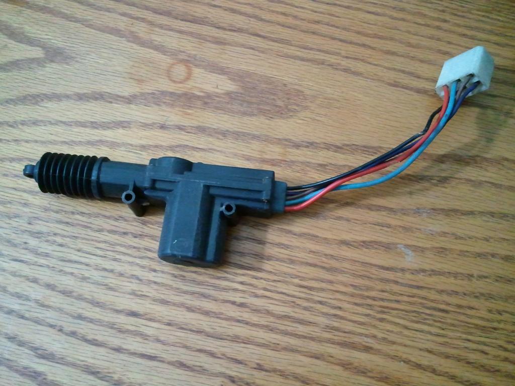

            I have here the actuator from the drivers door, like i mentioned, it doesnt lock, i have to manually lock it, but when i hit the disarm button on my alarm, it unlocks it completly, so is it a possibility of a bad connection?
            Black, Red, Light Blue, Brown, Purple are the wires
            Also ill have to take a look at the door jam like what Dave said, hopefully ill find a solution before getting a replacement

              That's an after market door lock actuator and installation. You can tell by the wire loom leading into the door. You can try swapping the actuator from the passenger door to see if problem lies in actuator or wiring. Also you can send 12v down a pair of the wires to see the actuator move in both directions. most often if a motor (or actuator) moves in 1 direction, it should work in the other.
              Since the other doors lock, the problem lies local to door actuator wiring.
