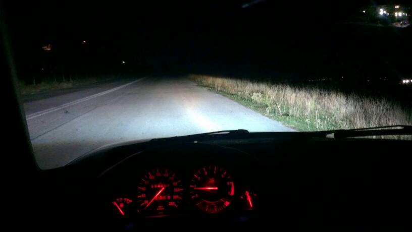

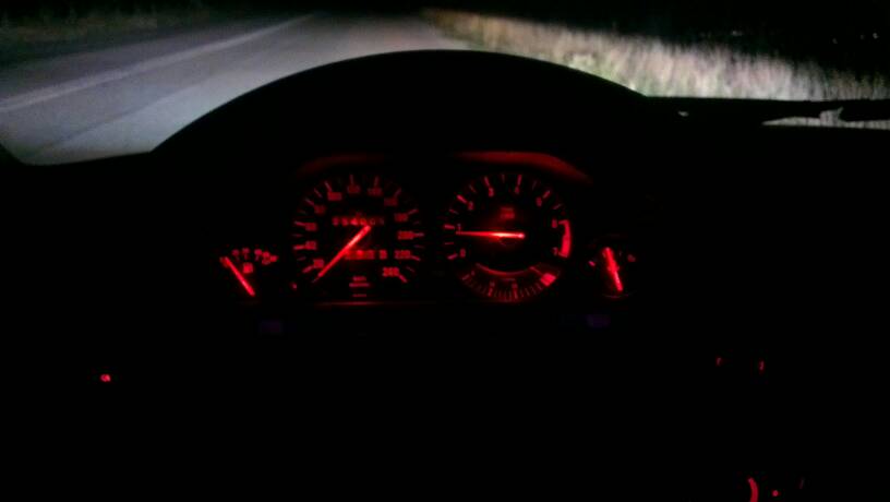

                I have remove the two orange plates to make a background light.
                I put red bulbs 5v without the orange cover and I put led rings under the illuminated needles from e36.
                The result is great and the light is like e46
                • alndks
                  • Nov 2009
                  • 79
                  You can see and a video here
