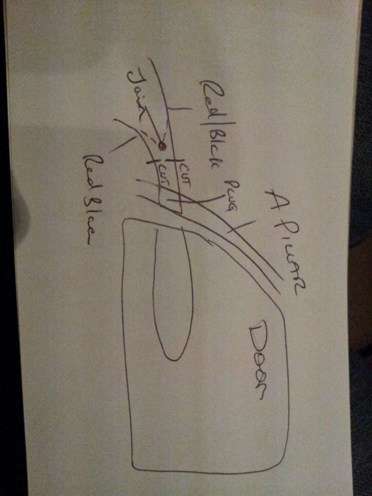

    Originally posted by rav320uk View Post
    Look at the pic below, it should make more sense.
    BUT, do you know what wire you cut from where????
    If so, join them back together and start again!!!!!!!!!!
    Look at this pic, it's simple.
    Yeah I know which from where, also silly I was confused for a second by the drawing but I forget you're from England :P
    So, basically just join the thicker wire with the thin wire.. ALRIGHT gonna go clean up my mistakes and try this again.
