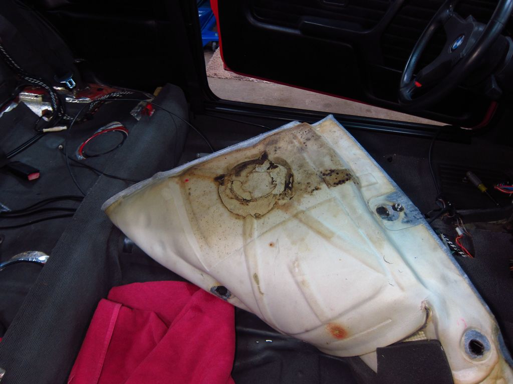

OK, so the towel I had in the floor pan. Not only is it useful, but it has lots of sentimental value, being pilfered from the pool area of the hotel my wife and I stayed at during our honeymoon many years ago. What better use for a treasured possession than to sop up the moldy water that had managed to accumulate under the carpet in my old car (besides, it isn't the only one we acquired).
I have been trying to figure out how the water got there and have not found an answer. This looks like a classic "crushed sunroof / door sill drain" issue, but all of my sill drains are nice and open, and a water test up in the sunroof shows everything draining perfectly. Based on what was wet, water was getting in down near the bottom-rear of the door, and it was UNDER the carpet rather than ON the carpet. I can find no rust, my door seals are pretty new and seal well, so it is a mystery. My area is slated to get a ton of rain for the next week, so I will be inspecting back there frequently to see if any more gets in.
I dealt with the moist carpet parring by shoving some scrap metal under the carpet and sticking a spare 140mm PC case fan in there for a couple of days over the weekend.
Today (2 days after closing it all up) I pulled the carpet up and it was damp again, but I think it is because the foam under the carpet is really good at retaining water. Even when it feels dry to the touch, squeezing it seems to release more water. So really, whatever water was in there could have gotten in months ago. Maybe I spilled something or did not have the door properly closed when it rained?
