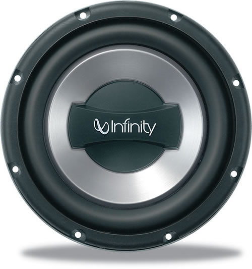

    For the sub, Luke recommended the Infinity Refererence 8"
