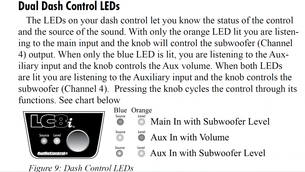

    OK, so here it is: the Audiocontrol LC8i. All it really is is a knob and an LED on the dash that plugs into a box. There are 2 sets of inputs, one RCA, the other "speaker level". When you push the knob it changes inputs. Simple, right?
    Here is the weird part...that knob functions as a global volume control AND a Subwoofer Level Control.
    When you are in "deck mode", using the 4 channel inputs, the knob is a typical SLC. Tap the knob to put it in "AUX Mode" and now that is the global volume for the system. Thus, the only poopie part is that you have to jump back to deck mode to change the sub level.
    What you do get is electronics that are incredible, far better than most high-end home audio stuff. The output from that single RCA input is stunning, you get 3 sets of completely adjustable 9.5VRMS, 13V peak line level outputs. Your amp will not want to see anywhere near that much input, so the thing never gets into distortion, only has super clean output. Basically, "idling".
      I have honestly never used the LC8i so I don't doubt what you are saying since you have experience with it, but based on the owner's manual for the unit, it says that to change sub level you have to be in aux (iPod) mode. I was thinking this would be perfect for my setup but might be a bother for more standard set-ups, but from what you're saying it might be the other way around. Either way, it'll work, I'm just hoping for the sake of my install that it is as it says it is in the owner's manual. If not, SLC control for me will kinda be a guess-and-check kind of procedure haha.
      • StereoInstaller1
        GAS
        • 22679
        Duh. You are right. See? Old man disease right there!
