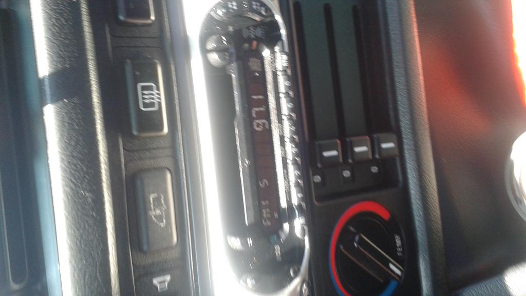

                            • E30Jigzaw
                              • 1197
                              I'm still rolling with a cassette player ")
