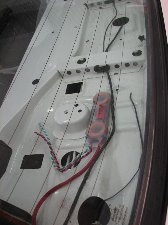

                        You need a 5 channel amplifier, GAS E3010 "Lukebox" sub enclosure, 10" woofer for the enclosure and also rear premium speaker housings are needed to house the extra rear tweeters.
                        I mounted my PCNs on the rear parcel shelf as shown in picture...Plenty of room.
                        Thanks, Stan
